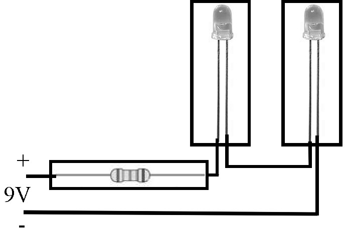

You didnot say what color the LED's are for sure. I assumed you are using white ones.
The 330Ω resistor may be to small of a value if you use the 9V power supply as the voltage may be some what higher than the indicated 9V.
I would try putting 2 LED's in series with the resistor and see how bright the LEDs on the 9V power supply. See attachment.

Yes. They are white ones.
I will try to put the 2 LEDs in series and see how well it works.

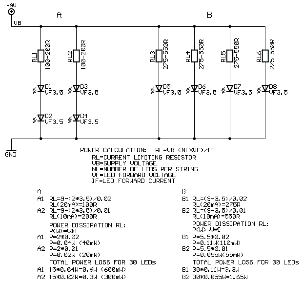

Hi alockrem,
you might reconsider the arrangement (and use) of current limiting resistors and the number of LEDs connected.
Please refer to the attached schematic and the calculations.
You might connect all LEDs with an individual current limiting resistor, dissipating lots of power in the resistors.
Connecting two LEDs in series does not only save 15 resistors (for 30 LEDs), but also reduces the total power loss by 2.7W (20mA LED current) respectively 1.35W (10mA LED current).
It doesn't matter much if you happen to have an own nuke power plant in the back garden, but even using that will save a lot of energy, thus taking care of less global warming. :D
Boncuk
