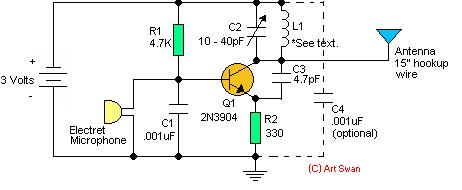

I just finished making my 3v fm transmitter but seems there was a problem because the signal are not stable it operates but suddenly the signal receive by the receiver is lost. would you please help me?

I am not surprised.
As soon as you put your hand near to this thing, the stray capacitance will change and the frequency will change as a result.
The antenna is connected directly to the circuit which determines the frequency, move the antenna, change its shape or bring another object near to it and the frequency will change.
C4 is not "optional" it is ESSENTIAL.
The circuit is at best a toy, at worst a piece of junk. I am sorry if this sounds harsh, but that is the reality.

This is normal for your circuit, simply because the antenna (doesn't matter what kind it is) is literally hogging the frequencies and sucking the signal out of the transmitter.
I think your best bet is to somehow attach a "buffer amplifier" to where the antenna is supposed to go and that might add stability.
Basically, you can have either high stability, or high range, but not both.

It doesn't have a voltage regulator so its frequency will change as the battery runs down too.
After all, that's how it makes FM. By the microphone changing the conduction of the transistor, which also changes the voltage across it, therefore changing its collector capacitance that is connected directly to the tuned circuit. :lol:
