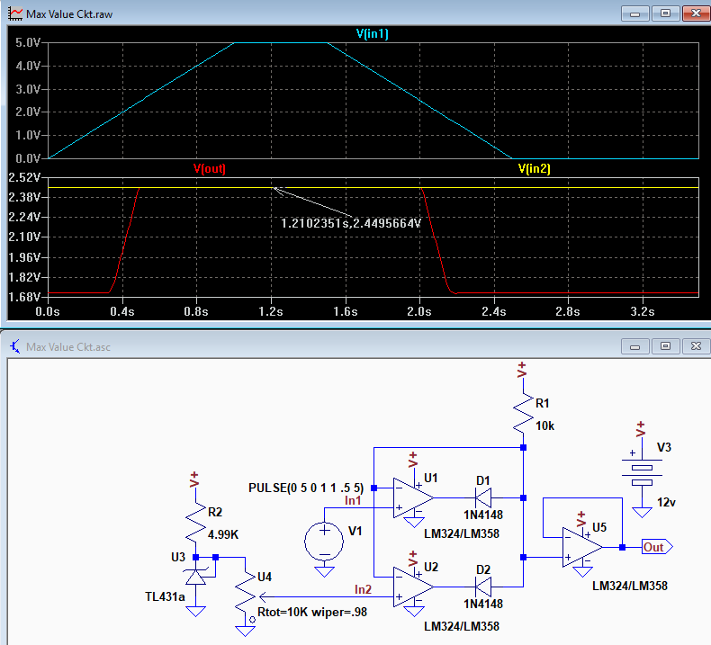

Please, how do I limit a peak DC voltage to 2.45 volts in a car MAP circuit?
Here's a three opamp (one LM324 package) circuit that will precisely clip the voltage at an adjustable reference input level.
The LTspice simulation is shown below.
The clip voltage is provided by a TL431 2.5V accurate and stable reference IC, and the level can be adjusted from 2.5V to 0V by pot U4.
As can be seen, the output is clipped at 2.45V for the shown setting of the pot.
If you don't need an adjustable clip level, you can replace the pot with two fixed resistors.

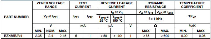

For that wide a range, the Zener approach should work, if it's set to clip at about 2.25V.
what are your thoughts about the one linked above in this thread that is set to clip at 2.4?
It would be problematic.
Look at the clip from the data sheet below.
The maximum zener voltage is 2.45V which is near your upper limit.
And its high dynamic resistance and soft zener characteristics may cause an error in the voltage around 2V and below.
Add in the high temperature coefficient and you could exceed 2.49V at low temperatures.

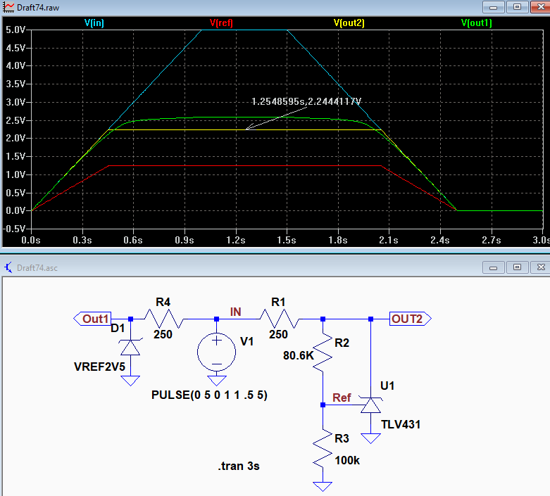

How about this slightly more complicated circuit (2 added resistors) that gives much better performance.
Below is the LTspice simulation of a clip circuit using a TLV431 1.24V programmable shunt reference (Zener).
It gives a more accurate, stable, and sharper clip point.
The TLV431 clips when the Ref voltage (red trace) reaches 1.24V, as determined by the voltage divider consisting of R2 and R3 [giving an OUT2 clipping value (yellow trace) of 2.24V for the values shown].
Note the much poorer clip at OUT1 using a standard 2.5V zener (green trace).
(I didn't have the model for the 2.4V zener but the performance should be similar).

The circuit in post #27 is quite simple with only 4 components (3 resistors and the TLV431).
Anyone that can solder should be able to build the circuit for you on a small proto board, such as this.
