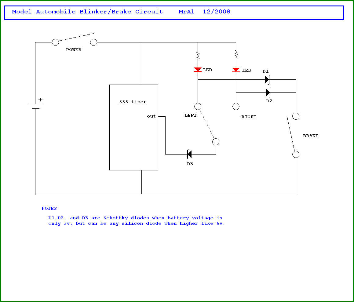

Hi Again MrAl
The actual part numbers are SA555 By T.I. and I have 10 of them. the resistors I have 20 each and the capacitors I have 5 each. Getting more parts with higher values is easy I only pay $1.00 for 20 resistors and the SA555's are only .49 cents each. I know I will need some diodes too but I don't know what kind or the values. Thank you for everything
Hi again,
Here is a rough layout so far.
The diodes are Schottky's if you want this to fly with 3v input,
and the red LEDs have to be the 1.7 to 1.8v type. You may
want to check that your LEDs can run off of a 3v battery
with a single 100 ohm resistor in series. See if the brightness
is acceptable.
In this drawing, you'll note that there is a power switch. If this
is not acceptable we'll have to go with another technique but
that will require more parts.
Check it out. Note the timing resistors and cap are not shown yet.

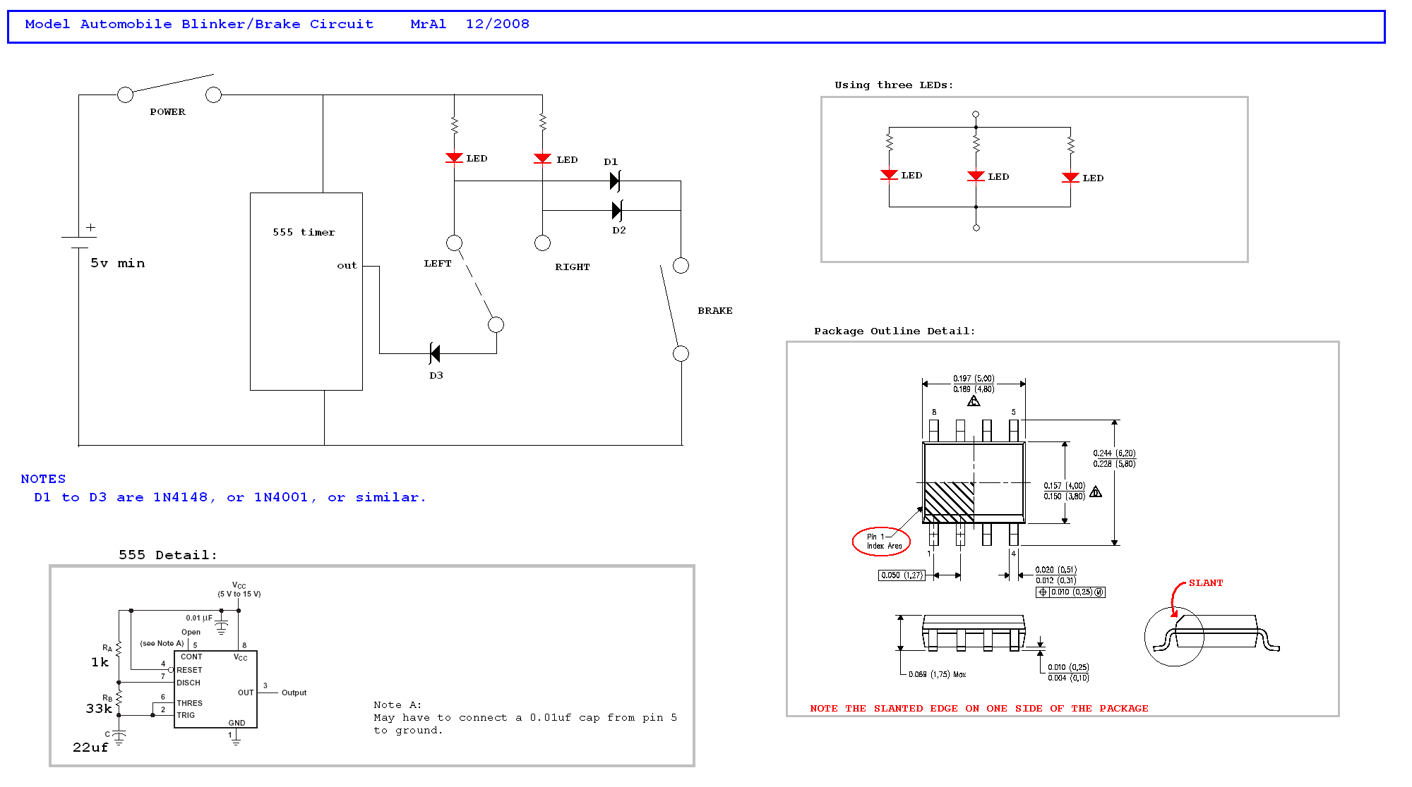

So far it looks good. I know it is just a rough drawing but I will need the pin layout for the SA555's and a Key to the parts. Like I say I'm dumber than than Dumb can be when it comes to reading a schematic. I can understand most of what you have so far but d1 &d2 placement is still confusing to me.
Thank You
By the way The Led's are rated at 3volt but can I stack the batteries for 6v or 9volt to keep the red Led's at the 3volt brightness? and if I can what resistors do i need. Another way I thought is if I hook the 3 led's in series what resistors do I need and do I need one resistor per bulb? I think the voltage would be 9 volts total, Am I correct?
Hi again,
I looked up the data sheet and found that the 555's you have require
at least 5v anyway, so that means at least 2 cells in series (for 6v
total). If you want to go with 9v that's ok too, but the resistor
values will be different.
If you have 3v LEDs then you can not connect them in series.
You would have to connect one resistor per LED and parallel
those.
Here's an updated drawing with more component values and
showing the resistors connected in parallel, each with their
own resistor.
Yes, the preferred method to connect LEDs is one resistor
per LED.
The diode connections are such that the two cathode (band)
ends go to the brake switch, and each anode goes to a different
LED. If you have any doubts, do a quick prototype breadboard
first.
The resistors for the LEDs will all be 300 ohms for 10ma or
150 ohms for 20ma with a 6v battery.
300 ohms with a 9v battery will give 15ma.
Is the power switch acceptable then?
Here's the updated drawing...
