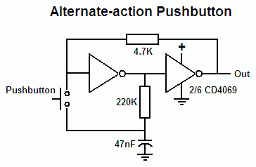

this is the project: i want to use a remote to activate a fan. if i use the 555 in a monostable way, it will activate the relay and remain stable untill the 555 times out as a result of the delay. now i want something that will be stable permenently utill i press another button to deactivate it. the circuits consists of an infrared transmitter and reciever. the reciever passes an impulse to the trigger (pin 2) of the 555 and then the output (pin 3) activates the relay. but how to make the relay remain permenently in that activated state is where the problem lies. contribution please..............!!!

how can i get the remote relay circuit please?. i have built the IR transmitter and the reciever using CD4069 hex inverter. ur support please.
Hi Timothy,
Connect the output stages of your CD4069 IR receiver like this:

audioguru said:
The pushbutton would be a transistor with a series base resistor.
Unfortunately the transistor CE voltage polarity changes with the states of 4069.
Hi L. Chung,
Transistors work when backwards, most Noobies find out. :shock: :shock:
Their gain is poor when backwards but they switch OK if you use a high base current. Since their base-emitter junction will avalanche when reverse-biased at about 6V to 7V, it is in series with a forward-biased collector-base junction so the supply voltage of the circuit should be less than 6.6V to 7.6V. :lol: :lol:
