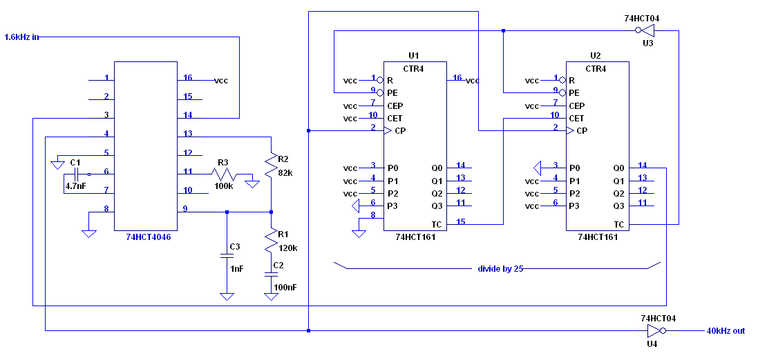

4046 with a /25 using a pair of 74HC160 programmable synchronous dividers.
FIN = 1.6kHz
FOUT = 40kHz
What would the loop filter be? the FIN will never vary. Can I use asynchronous dividers like the 74HC90?

Bill, I finally (my power supply died, had to fix it) breadboarded the whole danged *25 multiplier using a 74HCT4046 and a couple of HCT161's (and an HCT04). It seems to work really well. If you're still interested, I'll post the schematic.

It's perfect, thank you Roff. Hey I'm only 30 posts ahead of you!

OK, here are the changes for 3.2kHz in / 80kHz out. I think I made mistakes calculating the loop filter in the previous design, although it seemed stable.
I tested the new version by perturbing the loop at about 1Hz and watching the error voltage settle.

Thanks Roff
