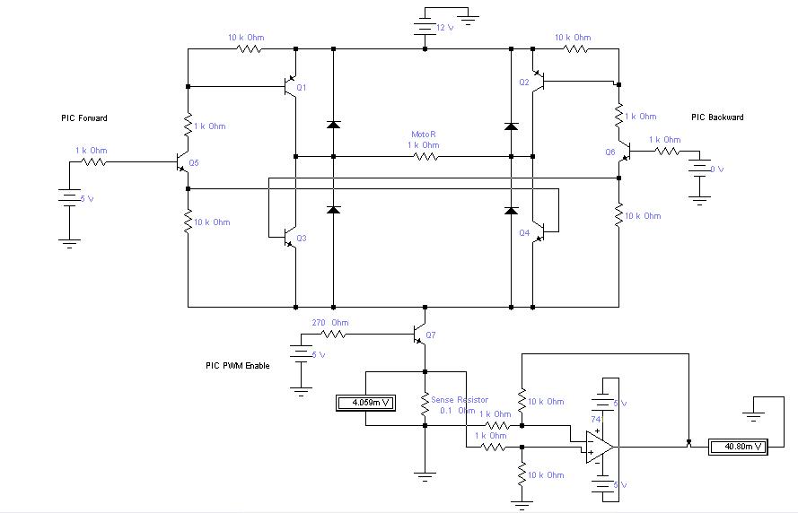

PLS help me confirm my HBridge current sensing schematic
fabbie
As you can see at the schematic, i placed a 0.1ohm sense resistor at the power supply negative rail. Furthermore, i used a differential opamp to amplify my voltage drop across my sense resistor to match my current flow across the sense resistor. From my simulation here, it might seem successful (except for a small percentage of error), but in practical i have to no idea wwhat will happen. Therefore, i just want to confirm and get the necessary confidence that this H-bridge with the current sensing will work.
Also, i added a transistor at the sense resistor for specifically for my PWM enable since im only limited to 1 PWM channel for 1 Hbridge driver.
Pls provide me with comments and opinions. THX THX THX :wink:

Looks mostly ok. Some notes:
1. I don't see any purpose for the 4 10k resistors on the H-bridge.
2. Why is there a "PIC PWM Enable"? If you make both inputs low, the bridge will be off.
3. The op amp will not work in this configuration. Fully differential setups like this generate large offset errors with mismatched resistors values. This will swamp the actual 4mV input signal.
But you don't have any need for a differential circuit, the resistor has one end referenced to ground. So a simple low offset op amp in a non-inverting configuration (2 resistors) will do fine.
This may not be a good op amp for measuring a 4 mV signal with any degree of reliability due to its inherent input offset voltage. Some versions of LM741 can have as much as 6mV of offset error. You can try to null it out with external circuitry, but there's still some thermal drift, it's just easier to start with a low offset part.
You do not need a dual supply op amp for this application.
If you are trying to send this current to the PIC's ADC, you will want a larger signal level than 40mV. Make it 100x larger. Check and see if your op amp has a 5v supply how much voltage it can put out, it may only be 4.5v or 4v or so if it's not described as "rail to rail". You will also need to filter the signal since it will be pulses at the PWM's freq.
Oh i didnt know that differential opamps generate large offset value compared to non-inverting opamps.
The 40mV simulated here is JUST AN EXAMPLE to ensure that my opamp is MULTIPLYING correctly. It is highly unlikely the current flow would be 40mV since i would be driving the motor(SORRY for not mentioning).
Do i really need to increase the opamp gain that high?x100. According to Nigel's tutorial, Vref/1023. I assumed that my ADC would be able to read small voltage even 40mV.
I didnt know there were non-dual supply opamps. But normally if im not wrong the -Vcc of the opamp is used to amplify negative voltage?
Lastly, how do i filter the signal? place capacitors between the opamp input and GND?

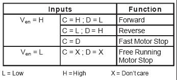

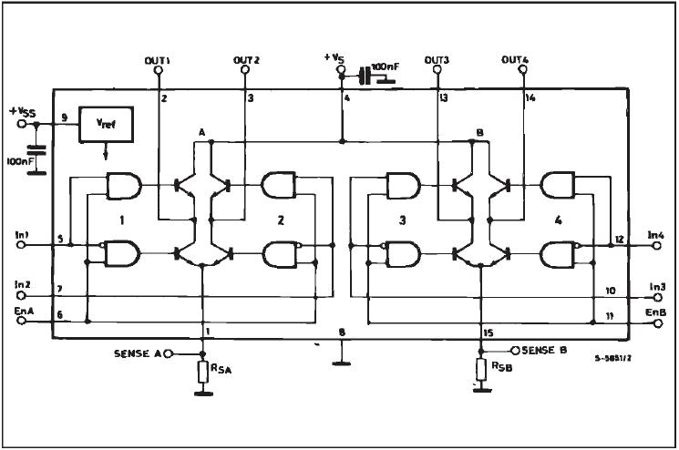

Here are 2 references which I extracted from the L298 datasheet. This should give you a rough idea of a pretty standard H-Bridge circuit. Note that the pics left out the diode bridge.
1) The basic idea is to keep the path of large current as simple as possible, and try to confine control circuits to low-current areas, ie logic circuits.
2) Is there really a need to use such a small sense resistor, then amplify the signal? Why not just use a larger-valued power resistor, and leave out your amplifier circuit. Using your circuit readings, 4mA across 0.1ohm is only going to dissipate 0.16mW of power. Standard resistors can support 0.25W-1W. Power resistors can support a few watts of power dissipation. Unless of course you are dealing with a micromotor circuit, then such a simple control scheme will not be sufficient.
P.S. You can always download the L298 datasheet if you are unsure of the pics.

My motor which is a 12VDC currently draws 300mA without any load(my schematic ampere value is just an example).
According to ohm's law, which is V=IR, IF my motor draws 1 ampere from my battery supply and if i use a larger valued resistor, the voltage drop across it would be far higher.
Since im only using a 12V battery power supply, I intend to let MOST of my 12V drop across my motor. I seem cant think of any other way

Also, i forgotten to mention this. The purpose im doing this circuit is to make an overload through the use of a PIC. In a worst case scenario, thea motor stalling of a 12V motor could shoot up to 4A. Using a 1 ohm resistor would have a 4V drop across it using V=IR.

The common point on the 741's supplies still needs a ground as stated in a previous post :?
No wories. Use a 0.5ohm resistor then. Detecting 2V is definitely easier than detecting 40mV for the PIC.
Or use 0.25ohm if you cannot find a resistor that cannot support the power dissipation. What matters is that you know the implications of changing these resistor values.
P.S. : 4A of current is pretty high. What power source are you running and what's the application of the motor?
Ok thx. I'll try to change to sense resistor to slightly larger(according to your recommendation).
Just to recap, the problem with the sense resistor tiny value(0.1 ohm) is mainly because of the opamp offset error am i right?

OK i'll keep that in mind. It changes my perspective in alot of things :idea: . Anyway, i hope my schematic design goes well.
I just want to confirm 2 things;
1) Does it matter whether i use differential or non-inverting opamp configuration?
2) If im using PWM signal, how would my current(ampere) waveform be like? I never really gave amy thought about the current waveform. Do i need some kind of filter to stabilise it or i can just leave it as it is. Since im building a current overload, im not even sure can the current drastically increase since PWM is used.

1. The differential is used only when the ground of your input signal is different than the ground of your output signal. There are a lot of problems with fully differentials so don't do it since you don't need it.
The "dual supply" configuration is only used if you need to read negative voltages, output a negative voltage, or your op amp's common mode input or output does not include ground (unusual). Your PIC would not be able to read negative voltages on its ADC and in fact can be damaged if you apply them.
2. It will need filtering. A simple RC filter with the cutoff less than the PWM freq will do nicely. Don't make it really, really low freq cutoff or it will be slow to respond to current changes.
The PIC's ADC reads Vref/1023. With a 5V Vref, that's about a 5mV step, and the PIC has an offset error of a couple of steps (check your part's spec). So with a 40 mV signal, you'd only be able to read about 8 steps total, with an uncertainty of maybe 25%. When you're doing an op amp, just go ahead and amplify it so the max signal you want to read will fit into the opamp's max swing and the PIC's max input voltage. A PIC driven by 5V should not be provided an analog input over 5V. If you're powering an op amp with 5V it can't output over 5V, many can only go up to the 5v source minus a volt or so.
