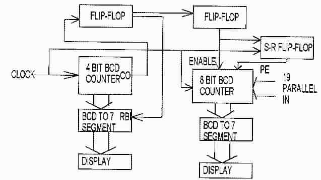

currently doing a project. but really have try it for 1 weeks but still cant figure out how.... so need u guys help pls.
here is the problem: need the circuit to count 0-9 first after 10 counts, it active the other display to count 19-0. then reset all back to 0.

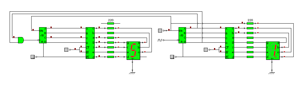

here is an shematic of a counter that counts from 0 to 99
forgot tu tel:
The to smal ICs are 4 bit counters and the to big ones are the 7 segment dispay drivers.
I got this circuit under exsampels in crocodile technology.

Let me try to understand: The circuit displays the 11th to 19th clocks as 0 to 9, then changes the display to 19 and counts down to zero. Is that it?
no. ok. first all display are in zero. when i press the button the first counter start to count from 0 to 9 and stop at 0. while this counter is counting the other counter should not be counting which mean that it will stay at 00. until when the first counter count from 0 - 9 and stop at 0 then it start to count from 19 - 0. then everything stop.
