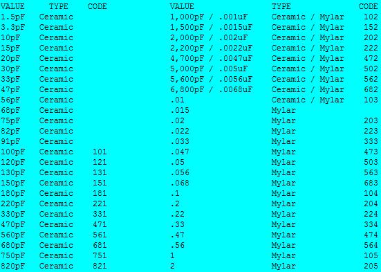

jrz126 Active Member Dec 24, 2004 #3 I have this pic saved in my electronics directory for easy access. It is quite handy...oh yeah, for the first caps. (1.5pf to 91pf) they will just be labeled with the value (33pf will be labeled as 33) Attachments capacitor_codes.jpg 50.5 KB · Views: 339
