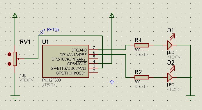

I'm beginning discovering a PIC world. Trying to build a voltmeter indicator, so it will turn LED on if input voltage drops lower than 3 Volts, and turn it back off it the voltage goes back. It sounds awefully simple, but I'm stuck for couple of day already. I'm using PIC12F683, in MicroCode Studio with PicBasicPro 2.47, and PICKit 2. I'd really appreciate if somebody could give me a code example how to make it work. Thanks in advance.

Here where I'm so far [see code below]. Conversion seems like working, but I can't make both LEDs go HIGH simultaniously! In other words when Vin somewhere between 86 and 170 both LEDs go into glow or blink. Is there a trick to make both of them go ON at the same time? Or am I doing something wrong?
PIC12F683 connections:
Pin 3 - Input 0-5V
Pin 4 - +5V
Pin 6, 7 - LEDs
GrnLED  VAR    GPIO.0   ' Define green pulse-width variable
RedLED  VAR    GPIO.1   ' Define red pulse-width variable
Vin     VAR    BYTE     ' Allocate A/D variable
'A/D Parameters
DEFINE OSC 8
DEFINE ADC_BITS 8		' Use 10-bit A/D as 8-bit A/D
ANSEL.3 = 1				' Set ANS3 as analog input pin
ANSEL.4 = 0				' Set A/D clock
ANSEL.5 = 1
ANSEL.6 = 0
ADCON0.0 = 1            ' Turn On A/D
ADCON0.2 = 1			' A/D channel 3
ADCON0.3 = 1            ' ?
ADCON0.6 = 0			' VDD is voltage reference
ADCON0.7 = 0            ' Left Justify result
'GPIO port pins 0, 1 as outputs
TRISIO.0 = 0
TRISIO.1 = 0
PauseUs 100
start:
    ADCON0.1 = 1        ' Start conversion
    while ADCON0.1 = 1  ' Wait for conversion
        PauseUs 100
    wend
    Vin = ADRESH
    if Vin < 85 then
        HIGH GrnLED
        'LOW RedLED
    endif
    if Vin > 86 AND Vin < 170 then
        HIGH GrnLED
        HIGH RedLED
    endif
    if Vin > 171 then
        HIGH RedLED
        'LOW GrnLED
    endif
    PauseUs 250
goto start

Looking at your code, you should have both LEDs turned on. If you haven't then I would suspect you are overloading the pic pins and causing a RMW problem. Try placing higher value resistors in series with your LEDs, something like 1K. Alternatively, place a PauseUs(10) after each write to an LED.

Can you post the circuit? That will help rather than all guessing.
EDIT: Download screen hunter (windows) or a program you can take a screen shot and post it. And you do have current limiting resistors on the LEDs like asked?
Here is the circuit. And yes, I'm using 300 Ohm resistors on LED.
Did you try 1K resistors in place of the 300ohms? And a 1K on /MCLR? If that does not fix it, I would guess it in the software.
