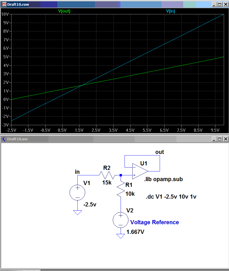

Hi, I have a sensor that outputs a voltage range that sometimes changes on me.
Usually, it ranges from -2.5V up to 5V or sometimes 10V. I was hoping that I could get whatever voltage output I get and map the voltage to 0- 5V. This means that the voltage output I want will never go above 5V and below 0V.
I need it from 0-5V because my other device will only accept a 0-5V range.
I'm not too shabby with the math and design of the comparator, and I hope you can help me with that as well. Thank You.

Hi, I should have been more specific. I don't have a MAP sensor. I have a laser sensor that outputs a voltage reading that can range from -2.5V up to whatever voltage. It changes on me at times. I was hoping to be able to map that output voltage, whatever it may be, to 0V to positive 5V.
A simple opamp with a specific gain, with a summed-in DC offset should do it.

The frequency range would range between 300Hz to about 1000Hz.
Could you help me with the specifics of the opamp, gain, and the DC offset? Wouldn't a comparator or using that TL431 work as well?
Ok, so if the input is at -5V, you want the output to be 0V. If the input is at +10V, you want the output to be +5V?

[laser sensor] --> -2.5V to 5,7,10V (voltage fluctuates) --> [black box(mapping voltage)] --> 0V to 5V --> microcontroller
The laser sensor is powered by a 12V power adaptor, but the sensor itself can operate on 9V. The output of the laser sensor fluctuates between the voltages I mentioned above. The black box will be the circuit comparator/voltage limiter that I need to make to take in that input voltage and output a mapped voltage between 0V to5V for use in microcontroller.
To answer your first question: yes and no. It would be similar to that, but in case i have a +7V or +8V or +10V input, I would still want it to be mapped to 5V. and yes I want to change whatever negative voltage input I receive up to 0V.
I can have a 9V or 12V supply voltage available. Sensor and supply are stable.
Thank you
Attached is a single supply circuit with offset. The voltage reference can be a TL431 or op amp. All op amps will need to be single supply type if you only have a positive supply.

Also, I am confused about mapping anything greater than +5 from the sensor to 5V at the input of the ADC. Are the sensor outputs >5V significant? If so, you likely want to map +10V to +5V at the ADC input (i.e. give up some of the ADC's resolution). If not, then you want to clamp anything above 5V to 5V?

The sensor has a negative and positive supply, sorry i forgot to mention that.
In your schematic, is the U1 just a regular op-amp? What specific one do you suggest I use?
Also, is it possible to not use a voltage reference in the circuit? Or is it necessary? If needed, how will I implement the LT431 to reach 1.667V to attach to that 10k Resistor.
Also, does this circuit have to share the ground with the sensor?
Thanks so much.

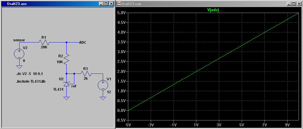

The voltage readings above 5V are significant. I would like to map the voltage above 5V down to 5V. For example, if I am getting a wave signal that goes from -2.5 to say 6.5V, I would like it to be mapped to 0V to 5V. If my sensor gives me a signal that ranges from 2V to 10V I would like it to be mapped to 0V to 5V. I hope that makes sense.
Yes, but you have to choose the gain setting apriori
Here is a simple circuit that doesn't need an opamp.
The independent variable is the sensor voltage (X-axis). The dependent variable is the ADC input (Y-axis)

Okay. What do you suggest I do? Will the schematic that the other replier posted work? And when looking at that schematic, how will I be able to implement the LT431 as the reference voltage? Will it be possible to not use a power supply(ref voltage) for this circuit and just have an incoming signal?

The output will be placed in a pin on the controller. The controller takes in a voltage of 0V - 5V. The pin would most like be a 5V.
What is the V1, 12V, of the schematic referring to? Will I need a power supplying 12V on that end?
Also, if V1 is needed, can you change it to 9V instead?
Any available power supply. Could even be the supply voltage running the microcontroller.

Okay. Does this mean that I can have V1 as 5V?

Yes, 5V will work.
