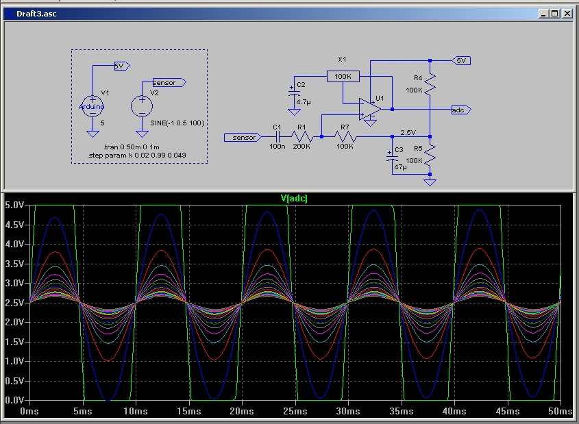

U1 is a rail-to-rail 5V OpAmp. X1 is a 100K pot. Sensor output can be anywhere from 1Vpp to 15Vpp. Output is always referenced to 2.5V.
Thanks Mike ill check this circuit out when I build it. How will I know how to change the value of X1 when looking at the oscilloscope? And once I get that value will I have to keep changing it accordingly?
Also can you explain what is going on in each segment or part of the circuit as it takes in the sensor's signal?
Look at the sim again. The sensor voltage is 1Vpp. With the pot set to get the green trace V(adc), the waveform is clipped. If the pot were set to get the blue trace, the waveform is preserved.

...Also can you explain what is going on in each segment or part of the circuit as it takes in the sensor's signal?
R4, R5 and C3 create a clean 2.5V reference (derived off the Arduino 5V).
C1 blocks the senor's dc component.
R1 and R7 create a voltage divider which drops the peak input by 1/3.
Since the right end of R7 is tied to 2.5V, the opamp's output is centered on 2.5V.
X1 determines the gain of the OpAmp. The left end of the pot is grounded through the capacitor to minimize offset from the 2.5V reference voltage.
The lowest opamp gain that the pot will set is 1, so the overall gain ranges from 1/3 (that is why the R1/R7 divider), to a much higher value as the wiper is moved left.
The frequency response is flat from ~10Hz to an upper cutoff determined by the opamp.
