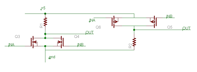

An inverter, AND gate etc can be built using P-MOS, N-MOS, PNP or NPN, vacuum tubes, relays and more. Moving from NMOS to PMOS is the same as moving form NPN to PNP. Dray the NMOS, turn the page upside down, change the +5 volts to ground and the Ground to +5, Change N to P.
Here is a 2 input gate. Input A, Input B and OUT.
One is made with NMOS and the other made with PMOS.
The resistor can be a resistor or a MOS transistor.

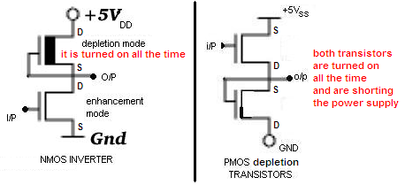

Depletion mode Pmos transistors need to have their gate voltage more positive than their source voltage for them to turn off.
Both your transistors are always turned on so they are killing themselves and the power supply.
You can use an enhancement mode PMOS as the load resistor in your inverter if you have a negative voltage to connect to the gate.

I'm thinking those are supposed to be enhancement mode transistors in the schematic posted by ronsimpson.
I was talking about the inverters by the OP.
In the circuit on the left, the driven transistor is enhancement mode, and the load transistor is depletion mode.. This needs to be the case in the circuit on the right also, and I think that was the OP's intent. I assume PMOS depletion mode devices can be fabricated, but I have not seen one.

this is an enhancement mode pmos....by the property of the pmos when the input voltage is high the o/p at the drain is low. So by that the circuit looks like this but where should the gnd be taken??
