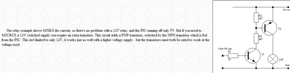

Your 5V signal that's switching the transistor really needs to get close to +12V to switch it off (12V - Vbe), but it's only getting to 5V. Think of that part as referenced to the +12V line. You should have the 5V signal control an NPN transistor, with the collector of that connected to the base of your NPN transistor, and with a pullup to +12V. Emitter would connect to ground.
Hope I explained that properly.

Another doubt is, the circuit below which active when microcontroller output is high.
But i want to source 12v for a relay when uc output is low.
So what changes should i make?
