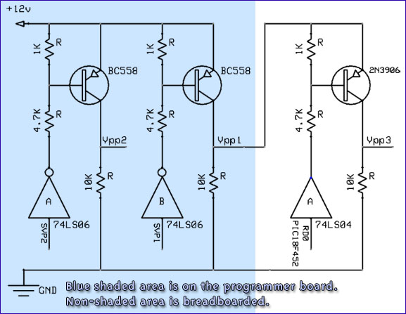

I'm definately not an electrical engineer, but I figured something this simple was within my limited grasp. I studied the schematic for my PIC programmer, researched via google, and found out the parts are ok substitutions. I want to be able to switch the 12v coming from my programmer board via the Vpp1/MCLR line to any one of multiple PIC chips. My programmer board does exactly that, but when I try to duplicate it on my breadboard, it fails. It works fine if the supplied voltage is 5v, but when I apply the 12v, it supplies 12v at the output no matter what state the input has. Could someone take a look and tell me what they see? Vpp3 is the output, and I'm using RD0 from my PIC to control the circuit's on/off state.

If you can configure your pic drive as open collector (drain) it will work. 74LS06 is open collector. Check the datasheet on which pins can be used in this way.
Ah, ok. Does that explain why when I disconnect the line from the 7404 completely (like a high impedence state) the circuit DOES shut off? I toggle high or low, and I have 12v, but leave the line not touching anything, and it shuts off. That's what confused me. Live and learn I guess, thank you!
Oh, I don't have any 74LS06s lying around. Maybe I could do this with (pnp)3906s or (npn)3904s? Thanks for the help.
Yes, if you put a 3904 in place of the 7404 and drive it from the pic you will be ok. You can also use the pic to drive it directly (without the 7404) when you have the output set as open drain.

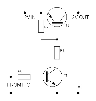

This is all you need!

The resistors aren't at all critical, 4.7K or 10K for all of them would be fine.
The circuit is extremely simple, and there's nothing really to go wrong, the PNP transistor is normally held OFF (the resistor between base and emitter reliably guarantees this), as long as no current flows through the NPN transistor. As soon as the NPN is turned ON, this provides base current for the PNP transistor turning that one ON as well.
If it doesn't work (pretty well regardless of values), you must have something wrong somewhere.

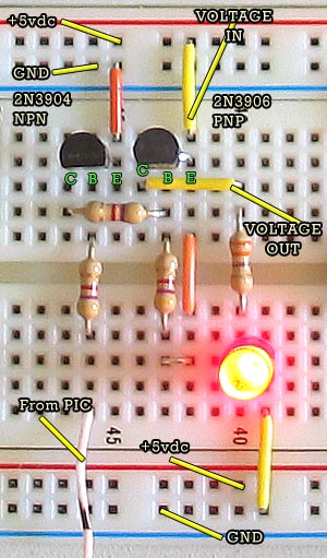

Here is a photo of the circuit Nigel, and I'll stop beating this dead horse. Notice that this photo was taken when 5v was used for the voltage input, but that's irrelevant for the photo.

You have swapped emitter and collector on both transistors. Rotate them 180 degrees.

Oh my, do I feel stupid. I even have 3906 transistors on the breadboard, with the emitter clearly marked. I don't know what I was thinking that caused those to be turned around. All that time waisted for such a stupid mistake.
It's like searching for your glasses, and they're on your face. :oops:
Thanks Ron and especially Nigel for the patience. Wow.
Oh, it works fine now. Voltages are fine, after I discovered that the weird negative voltage readings on my DVM were caused by one of the probe cables being too close to my halogen desk lamp. It's been an interesting morning!
With them connected backwards their base-emitter is breaking down with 12V, but not with 5V.
That's interesting. If I didn't lose so much time for my stupid mistake, I was thinking of setting up the circuit in reverse again and test it. Funny, but when it comes to my TTL and MCUs, and electrolytic capacitors, I'm really careful of orientation, because of scary past experiences probably. :roll:
