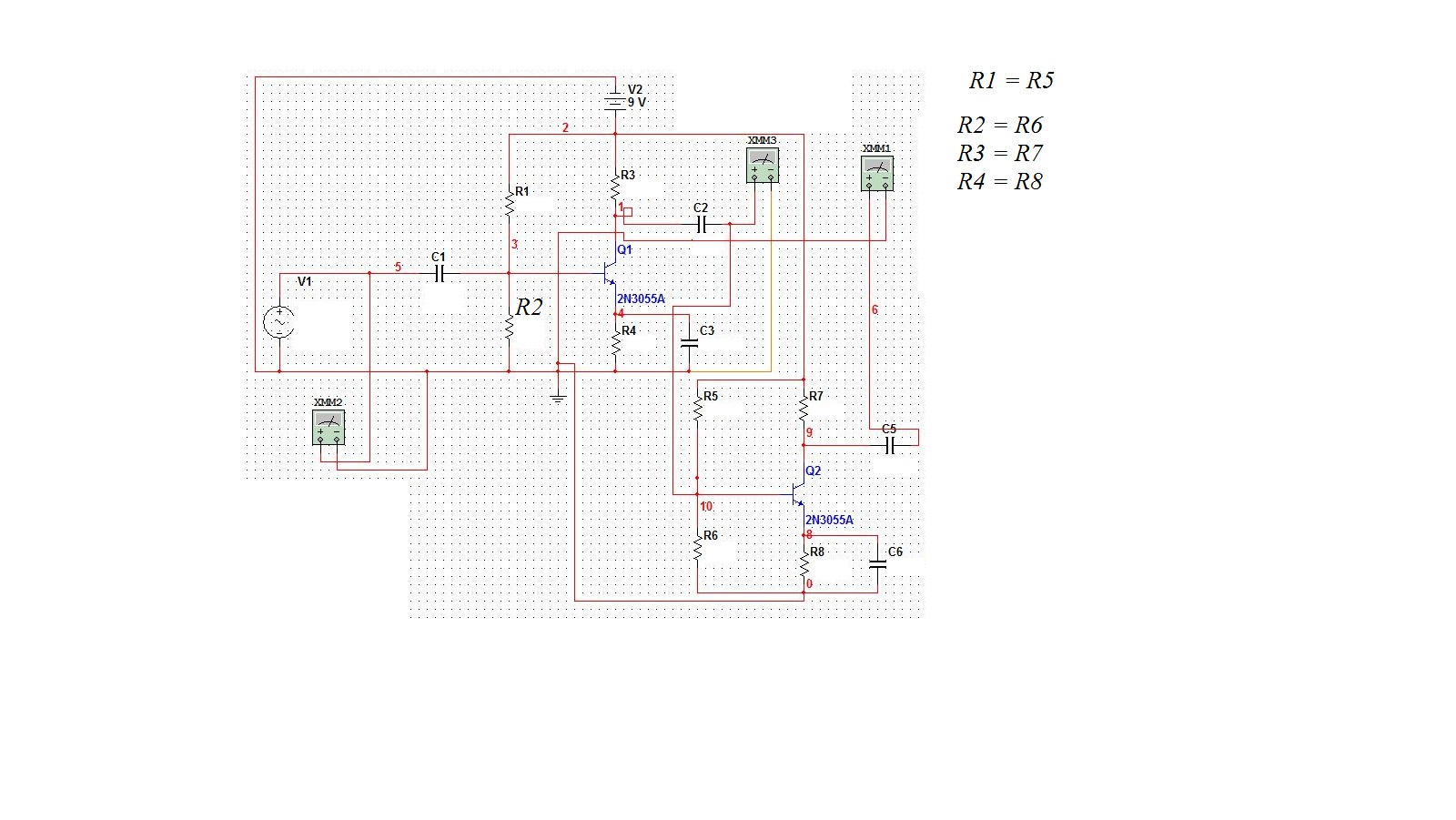

i have a project on our electronics major, we have to design a pocket sized guitar amplifier. the problem is there are certain things that i do not know
note that we have to calculate all of the components we have to use, we can choose our own transistor but we need a computation on all of the resistors we have to use. can you please help me answer all of the questions clouding up my mind. here are few of those

Sorry to be the bearer of bad news - but your 'design' is a complete disaster, it wouldn't be any good as any kind of amplifier. If I was marking the course you'd get a serious FAIL on that, and if it was within my power you're be thrown off the course - I'm presuming you're doing an electronics course?, although that is so bad I can't really believe it?.
why? wouldnt it amplify a signal? we are not encourage to use ic because we have to learn the concept of a transistor amplifier, whats so bad about that?
I suggest you read up about audio power amplifiers, particularly their output stages. A quick google will also find you the typical pickup output level.
I don't know the output of a pickup but I would guess 10mv. The 2n3055 would make a terrible first stage amp. I wouldn't use much more than 12v to a 3 watt speaker. You will need more than 2 transistors to drive the speaker.
You do not select the hFE of a transistor. Some are high and others are low. The datasheet shows the range of hFE. Design for the lowest hFE at your maximum current then ANY transistor with that part number will work.
3W in an 8 ohm speaker is (the root of 3 x 8=) 4.9V RMS. The peak-to-peak output voltage is (4.9 x 2.828=) 13.85V.
The output stage will be an NPN-PNP complementary pair of emitter-followers that need a power supply of about 16V or more.
A voltage amplifying transistor or two is needed and the input should be a Jfet with an input resistance of at least 3M ohms.
Negative feedback sets the gain and reduces distortion. A small capacitor is needed to eliminate oscillation at a high frequency due to phase shifts.
The output level from a magnetic guitar pickup is a FEW VOLTS when it is played strongly.
Why didn't your teacher teach you this stuff?
Your circuit is a common-emitter voltage amplifier driving another common-emitter voltage amplifier. Almost no audio power amplifiers are made like that.
The extremely simple class-A heater (oops, I mean power amplifier) will probably burn your pocket and burn your skin under the pocket.
Almost nobody uses a class-A room heating amplifier like that (but some weirdos do).

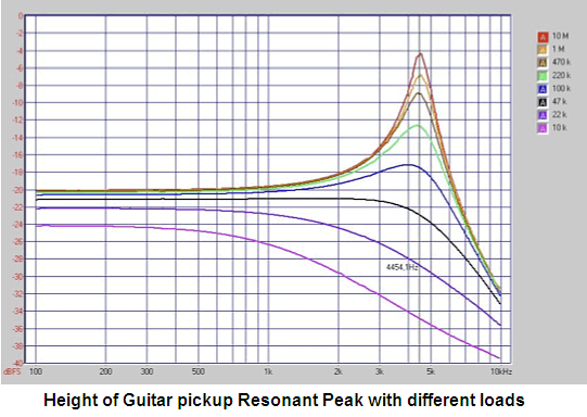

Actually most guitar pickups run pretty hot, 1v or 2v p/p is not uncommon when the guitar is played hard.

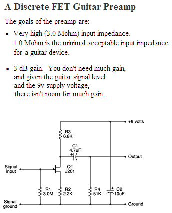

Here is a typical guitar pickup preamp circuit. It has very small voltage gain because the output level of a pickup is pretty high.
It has a high input impedance to allow the pickup's inductance to resonate with the cable's capacitance and produce a "twang" sound.

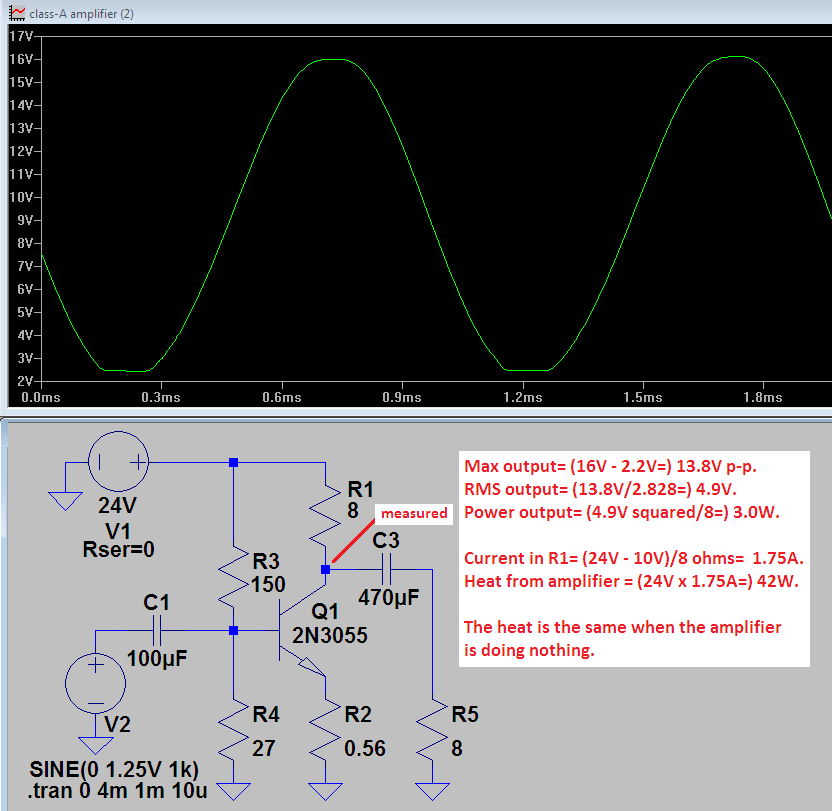

Here is your 3W class-A amplifier.
I needed to increase the supply to 24V to get an output of 3W into 8 ohms.
It draws 1.75A from a huge 24V battery.
It dissipates 42W of heat ALL THE TIME even when it is not doing anything.

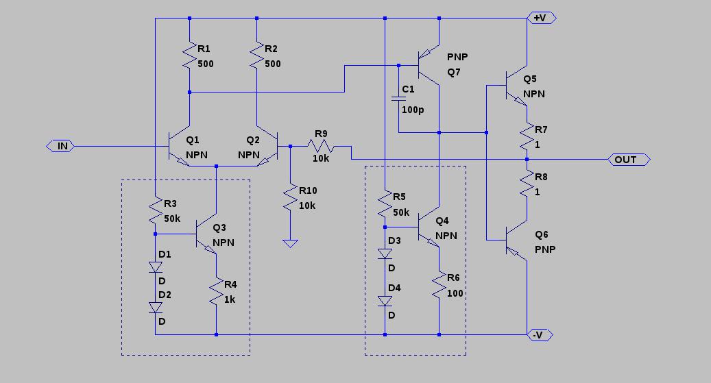

i'm not going to give you a complete design, but maybe you can get some ideas here:
https://www.electro-tech-online.com/threads/has-anyone-built-this.473/
basically what you want here is very much like an op amp, but made with transistors, not a chip.
you could use class A, but you a)need to get rid of lots of heat, and b)need to stock up on lots of batteries. class AB or class B (like class AB, but uses less idle current and has fixed bias) will not act as a space heater, needs much less heat sink mass and surface area, uses very low idle current, and doesn't eat lots of batteries. the 2N3055's you had are overkill. TIP31 and TIP32 output transistors (or something very similar) would probably be more than adequate.

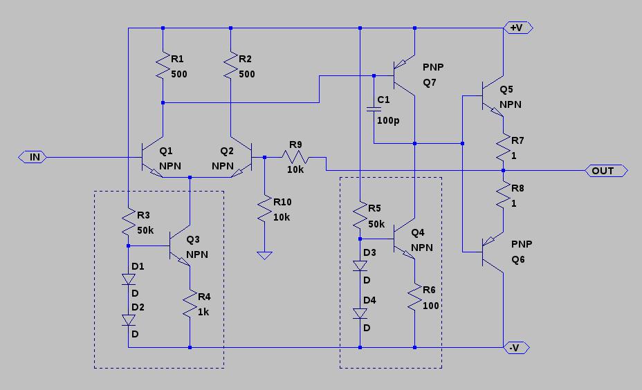

how about something like this? you will have to change the ratio of R9 and R10 to change the gain of the amp (Av=1+(R9/R10) and figure out on your own what transistors you need. this amp is also "fixed zero bias", so it will have some crossover distortion, you can add a couple of forward biased diodes between the bases of the output transistors to add some bias, and adjust some of the other resistor values to lower the distortion. as i said, i'm not going to do your schoolwork for you, but this schematic is a good starting point. i also recommend you study up on how each part of the amplifier functions, because if i were your teacher, i would certainly be asking you questions about it to see if you know what makes it tick. again, you can look at the article i posted earlier to get the basic idea of what goes on in this amplifier. there's no sense (especially with this being an assignment) in throwing together something somebody else has designed without some clue how it works, and why it's designed the way it is. and i will warn you, this circuit is a rough draft i use for teaching amp theory, the design needs several "tweaks" before it is even a prototype, let alone a finished product. there are a couple of "gotchas" in it (such as the lack of output transistor bias) but that's what makes this an instructional design.
and BTW, you will find that the way this circuit works tends to make individual transistor characteristics not very important, so you don't have to worry about choosing devices with the right Hfe. this circuit will function reasonably well (when you get all of the "gotchas" taken care of) with a wide range of choices for transistors.

Unclejed's circuit will work very well but its has transistor Q6 connected upside down. It is supposed to be an emitter-follower.
His circuit has a dual polarity supply so it will need biasing at its input and three added coupling capacitors.
Also the battery needs a bypass capacitor.
A high input impedance preamp will be needed as I showed.
tnx AG... fixed Q6...... must have been one of those things i drew at 3am..... or zero-dark-thirty....
