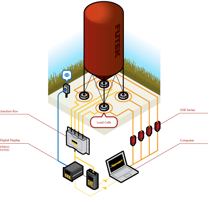

If you can lift the silo, Load cells are a great option.
https://www.futek.com/application/load-cell/Silo-Measurement

I know it's polystyrene beads but they still weigh over 50 tonnes. The pressure at the bottom must be immense. A rubber bladder with a pressure sensor might be worth exploring.
Yes rough calcs its about 40 psi, that has 2 problems to solve, one is the bladder would have to be thick enough to be able to compress the air within without the sides touching, and I dont know where I'd be able to have such a thing made, assuming I was to have something the entire surface area that is, maybe a smaller one would work.
Sounds like a similar idea to a load cell and a plate to measure a portion of the area in the bottom of the tank, I've never seen anything like that done.
Do footballs still have bladders? Could a hot water bottle suffice? Maybe a football itself could be a bladder. The available solutions are immense.
I think I mis-explained, originally I thought you meant a bladder the full area of the base.
Various smallish industrial bladder type assy's are available from air bellows to hydraulic accumulator ones, conveniently with a fitting on the end.
I like the idea of say a 12" square fastened to the bottom with a load cell attached, the hole in the bottom of the silo is 12", any larger than that and it would be a big job, as the whole thing is welded up apart from a vent at the top, the hole for the original guage and the hole just mentioned at the bottom.
That should work. It's a sufficiently large area that there is little likelihood of the beads forming an air-trapping 'tent' over the plate (which would reduce the pressure on the plate).
The problem with load cells/strain gauges is that they drift. They're fine for measuring tank levels as part of a short term batching operation where the tank fills and then completely empties frequently. When it reaches the empty part of the cycle, then the load cell is re-zeroed, so that the drift errors are regularly corrected. When used for long term level measurement they are unreliable due to the drift.
Well that kinda poo poo's that then, still good to know however.
The tank remains part full all the time, or the plant would shut.
So the way to do that the would be to use the bladder idea.

Drift is barely an issue on a 50 ton silo and 20 ton refills.
You will be refilling at least every two weeks, I assume.
I don't think you need even kilogram resolution. You just need an alarm/notification to let you know the silo needs to be refilled. You are not using it to dispense, right?
5% tolerance is good enough, your right this is just a 'fuel guage', refills can be 2 times a week to 2 weeks.
However the silo is hardly ever empty, wont drifit accumulate, or will it just hover around a few %.
The proxy's seem like a good idea, ready made and can be just dangled in from the top.
Load cells were used all over our plant. I've never heard of so much concern about drift. You can deal with it. Get the right meter or build your own. https://www.ti.com/lit/ds/symlink/lmp8358.pdf
Done that, used a amplifier (Hx711) with the arduino, the output string is compatible with usual software, the operator zeros it all the time.
