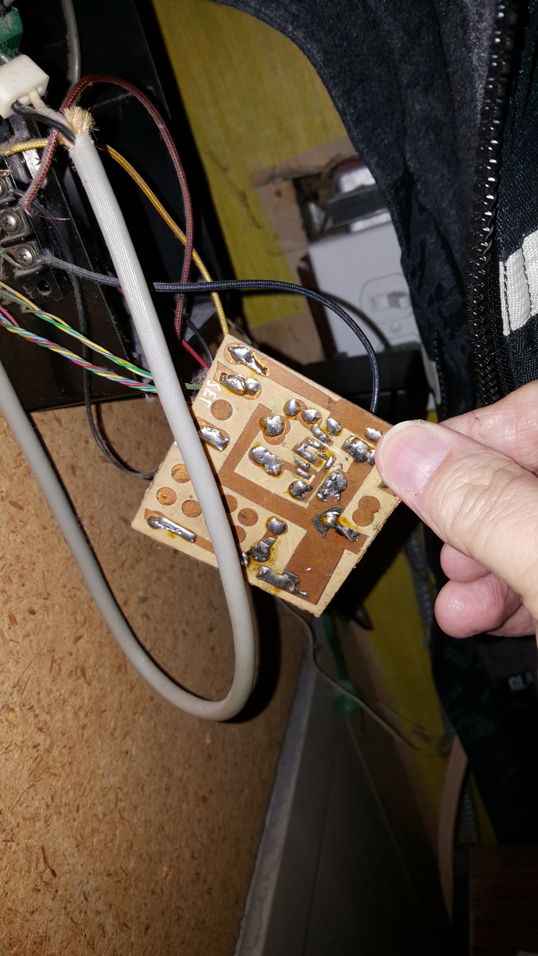

Here is a wonderful circuit board I hand etched about 38 years ago that has been hanging in open air in the laundry room ever since. The copper has been protected in no way. As I said, in a non-corrosive environment, bare copper circuit boards will survive a long time.
No worries guys, thanks, looks like I can leave it at that. It's not going to have tiny traces, I'm making everything as big as possible... less headaches working with high precision.
