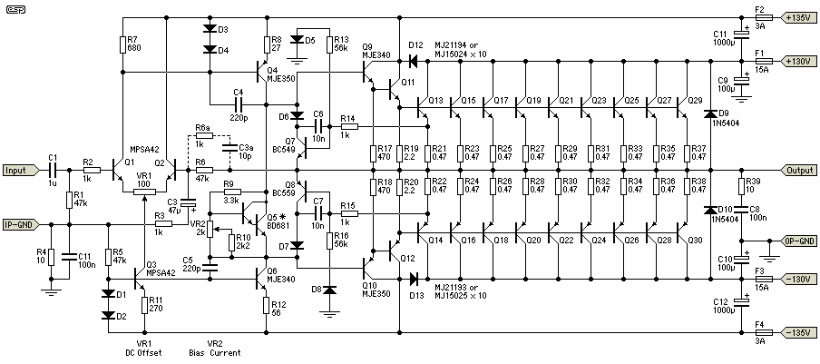

hello.. i need help about amplifier especially the project featured in ESP. the Project 117. this project is provided as information only. my question's are what are the suggested working voltage for the electrolytic and ceramic capacitors in the schematic diagram. and the suggested value for the diodes. thats all.

maybe you can use 1N4148 for the diode, for the ceramic you can use 500wv volt, for the filter capacitor it depends on the power supply voltage. if you use 130volts then you can use a working voltage of 160volts or higher.
you can modify that circuit by ommiting the 135volts supply and ommit the two diodes.
that project is an experimental. you should know how to set the bias voltage of transistors. especially the dc offset and current.
yes.. D12 and D13 mayde ommited in the circuit... can I lower the supply voltage from 130volts down to 80 or 90 volts? without changing the power output transistor?
