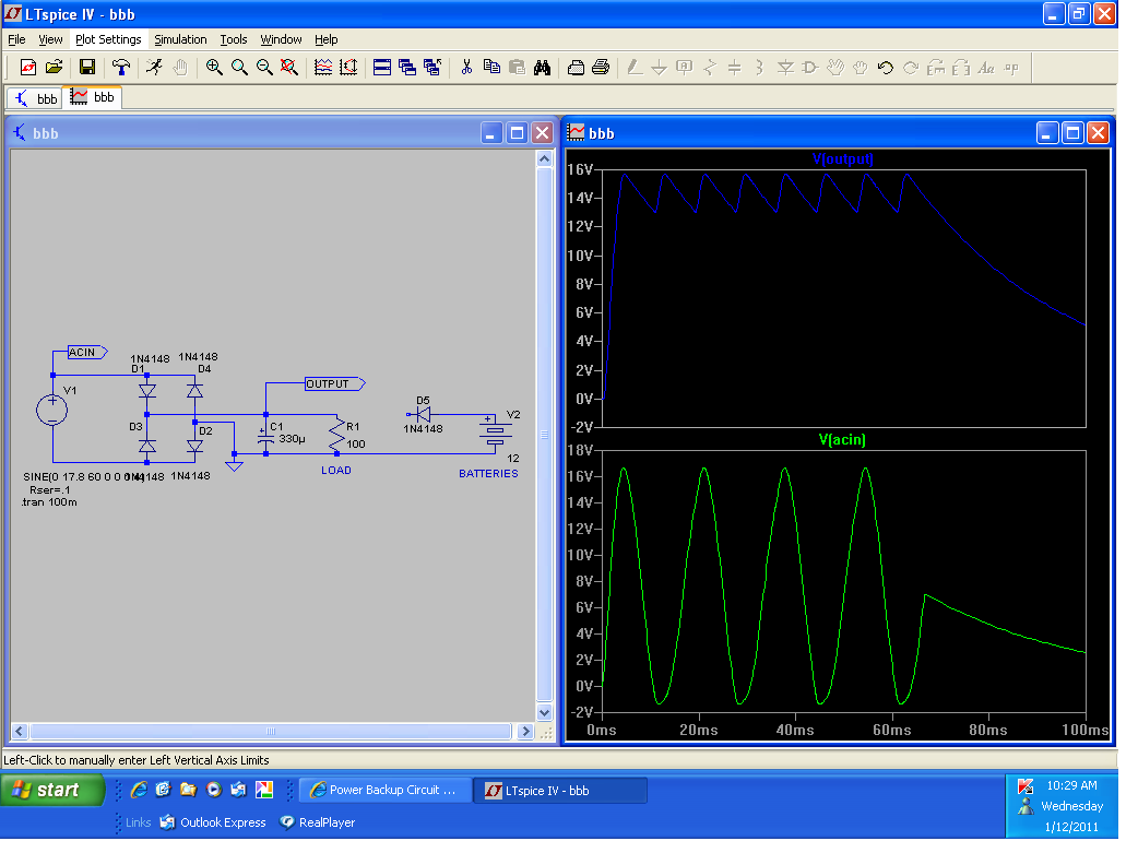

Backup
Since you only use the batteries when power is lost I think you will be ok. I think AA are about 2200 MAH so probably at least 50 hours powering the PIC. I'm not sure I wouldn't replace the regular batteries with rechargeable just to avoid the time when they do go dead. I think you only need to do 2 things. Add a filter cap to your AC supply so the battery doesn't act as the filter. Then a diode so the battery is only used when there is no AC.

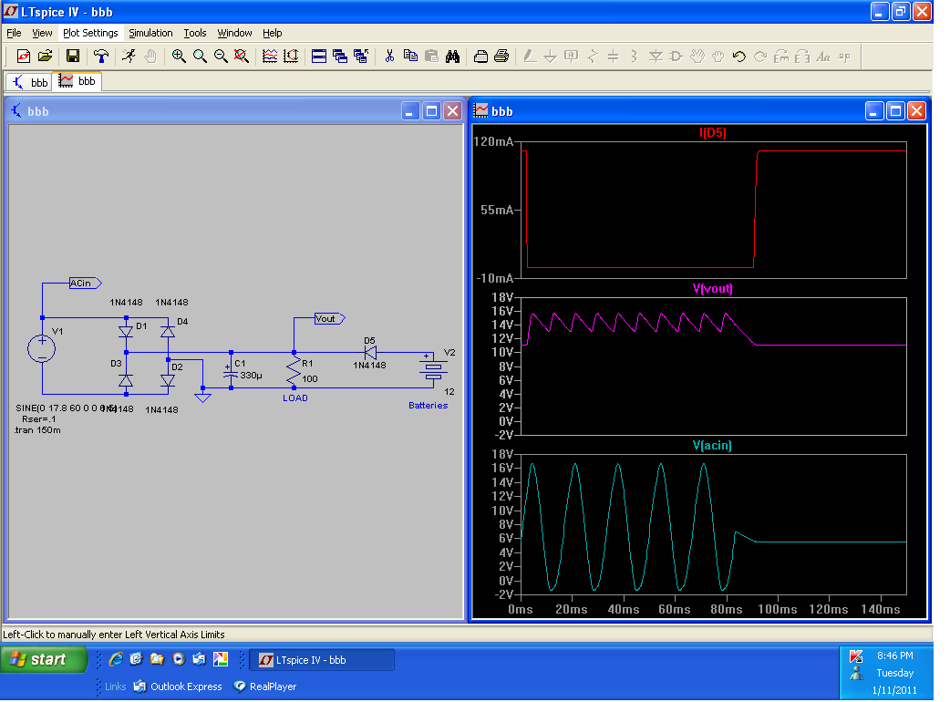

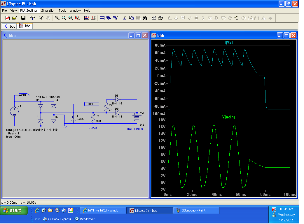

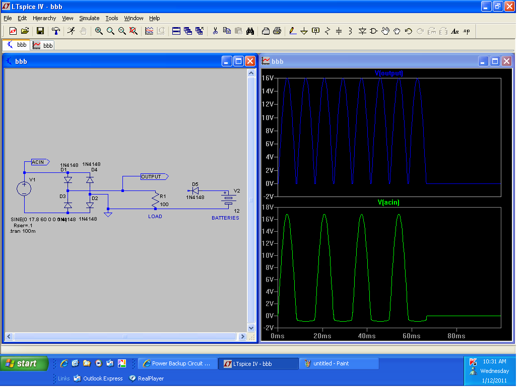

Filter
A filter cap is like a little battery. It helps to smooth out the AC from your bridge rectifier. In this case I chose 330 UFD so the voltage to your solenoid and battery would stay above 12 volts. Fig. 1. Without it the output voltage would look like Fig. 2. As you can see it drops to 0 volts in between cycles. In your case this would discharge the battery.
I'm not sure a rechargeable system is good because the voltage from rechargeable batteries is lower so you would maybe need more of them to power your solenoid. Having said that, if you use rechargeable I would use Ni-Cd just because you can trickle charge them all the time without damage. Fig. 3.
