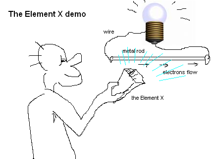

The Element X
Today, on a mad time, I was thinking about lots of mad ideas and finally came up with this one.
It is an answer to all power problems..you just need to find the so called 'the Element X'...I dunno I lost it somewhere sometime..let me know plz if you find it.
Thank you.:)
