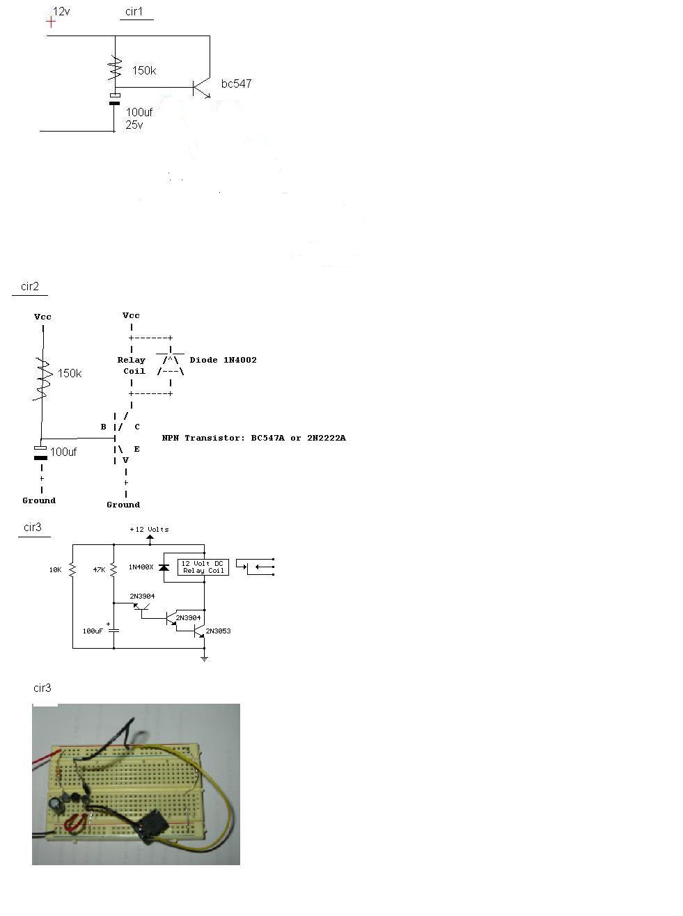

i need a circuit so that when power is applied to it the a relay will close after about 10 secs and stay on. It should be a very simple circuit but i have tried 3 circuits now and none have worked.
cir1 = worked perfectly for a led but outputs a maximum of 5v (not enough to drive a relay)
cir2 = i thought i had it working , but all it does now is outputs 10v straight away there is no delay.
cir 3 = i couldn't get any 2n3053 so i used a 2n2222, when i use a led as an idicator it is very dull until i tap the 47k resistors led with metal and then it brightens (there are no loose connections), so basically it doesnt work either.
can someone please tell me how to get any of these ciruits to work or could someone suggest another circuit to try.
please help

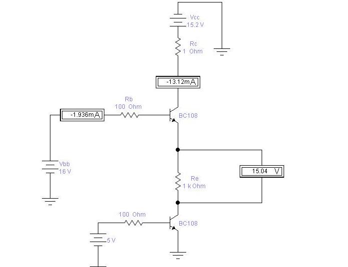

is this circuit how i do it, if so what size should the resistor be ??
