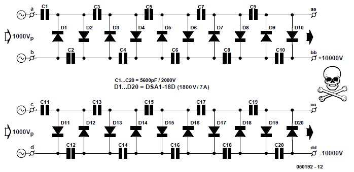

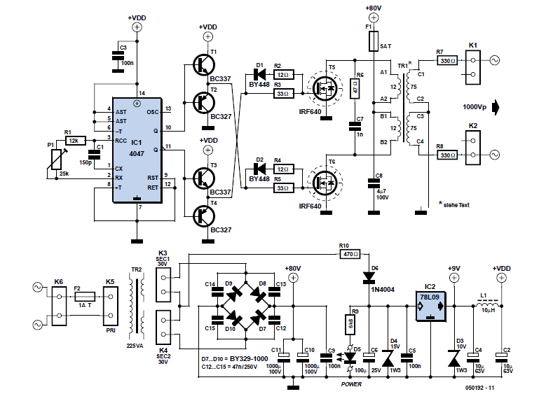

how about using an Elektor project? I don't know the English title. The German title is "Lichtbögen auf der Jakobsleiter".
The article was published in March 2006.
The circuit works with standard parts except for some diodes and capacitors. HV is generated by using HV-cascades consisting of a diode-cap network from 1,000 to 10,000V.
Here are the main circuits.
I also attached the full article (German).

Not very useful for a Jacobs ladder.
Looks similar to a Marx Generator, but seems like I remember a spark gap at each stage. There was a website dedicated to the Marx generator, might do a search. But if all you are looking to do is a Jacobs Ladder, the neon sign transformer can't be beat. Simple, cheap, and tough to destroy. I've never ran one for more than a few minutes at a time (noise/ozone), but have read plenty on the car coil designs, which seem to run hot, fail frequently, and a few minutes run time is about as good as it gets.
