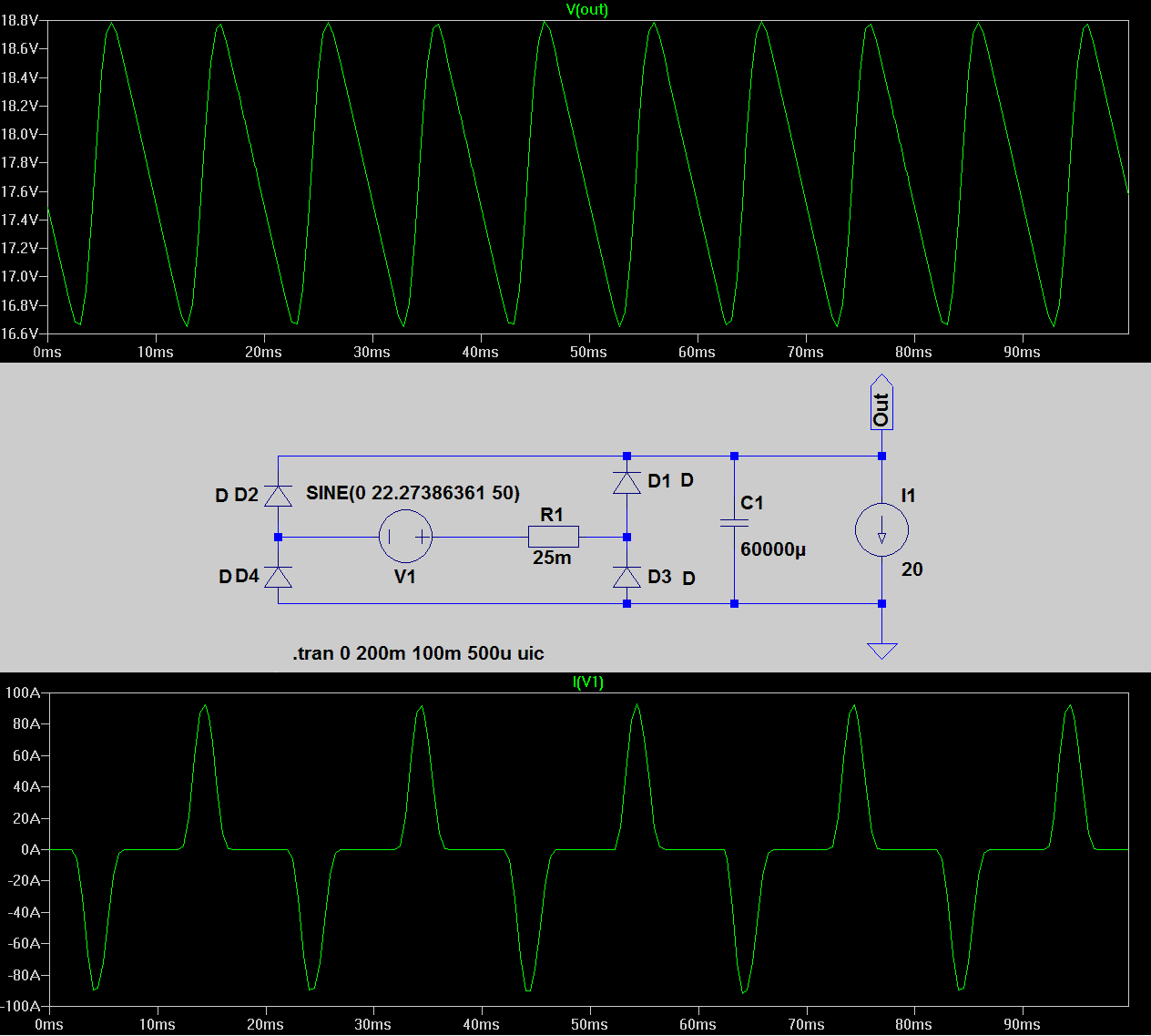

A 60000uF capacitor, used at 20A, and discharging during almost a half cycle at 50Hz (10ms), will drop the voltage by almost 3.3V
LTSpice says 2.55V of ripple at 15Vrms with a 20A constant current source on the output; this is assuming the transformer is perfect which I know is not true.
We need to calculate the equivalent series resistance to model this correctly. Suppose the 15V 30A transformer regulation is 5%, the off load voltage will be 15.75V but if it's loaded with a resistive load that draws 30A then the voltage will drop to 15V, the equivalent series resistance will have 0.75V across it at 30A, therefore ohms says it will be 0.75/30 = 25m:ohm:.
Accounting for the series resistance and the rectifier voltage drops, LTSpice says the ripple will be 2.2V, the peak will be 18V and the valley is just over 16.6V, if the regulator drop is really just 2V then we have 0.8V to spare. I do agree that if the mains voltage is on the low side it could still be a problem but this normally isn't the case in the UK. I don't think I've ever measured a voltage below 228V, it's normally 235V to 240V.
On the other hand, if you use a regulator with a lower drop, and/or a larger filter capacitor, then you can slightly ease the transformer voltage requirements. This can be very useful to keep the filter capacitor voltage rating requirement at 25V, since otherwise you would be forced to use a 35V capacitor, which is much larger and more expensive. A lower transformer voltage is also an advantage from the efficiency point of view. After all, the complete excess voltage has to be burned off by the regulator, causing a huge power loss and requiring a large heat sink!
