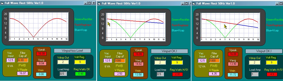

I assembled this circuit this morning, and it mostly works!
However, I only seem to get 6.81v output, which I don't understand.
The rectifier is a L7809CV.
I'm using the 12.5v connectors on the transformer (although it's actually producing a little over 13v).
Does the type of smoothing capacitor matter? It's definitely 0.33uF, but could I have the wrong type?
The resistor and LED do cause a bit of voltage drop. If I remove them I get an output of about 7v.
How can I get a nice steady 9v output?
I have found my answer, though I don't understand it...
The smoothing cap I was using was 0.33uF, which is what they were using in the datasheet.
This was far too small. I swapped it with a 47uF cap, and all is now good.
Why is this happening? Is there a formula to determine the correct smoothing cap?

Mark,
Your cct, which I edited for you, clearly shows 2 electrolytic capacitors, which are essential for correct psu operation.
It will not work correctly with a 0.33uF.!!1
Mark,
Look at this image of your psu operation.
The left image is with a 0.33uF and the centre image a 1000uF, with a load current of 0.5Amp.
You can see on the left image the 0.33uF cap has no smoothing effect and is applying a full wave rectified voltage to the 7809 input.
The rightside image is when the load current is 1Amp, using a 1000uF.
Dont remove the 0.33uF, add the 1000uF in parallel as shown in the edited dwg.
