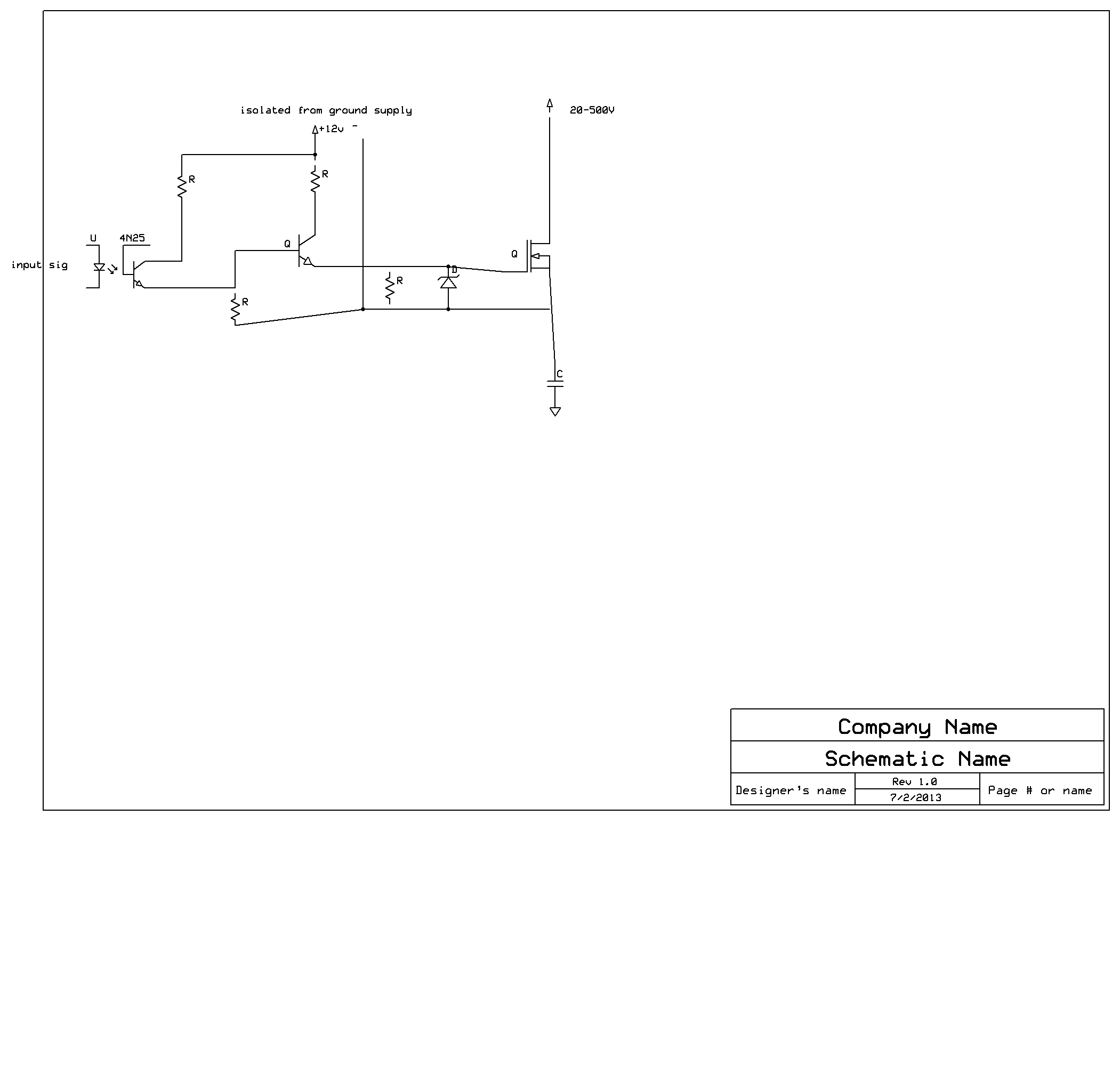

Is there anyone here who likes a switching circuit challenge? (although it may not be much of a challenge for an electronics engineer)
I've been trying to solve a little switching problem, simple as it should be I've only come up with a somewhat complex answer.
I have a 12V on/off signal source I need to use to switch high voltage up to several hundred V. The high voltage will be used to charge a film capacitor, and the charge power needs to be turned off during capacitor discharge, since it will be virtually short circuit discharge. The charge/discharge cycles will run about 15 per second up to as high as 25-30 for some applications.
Both power sources and the capacitor are on common ground.
I have HGTP10N120BN IGBT transistors for switching the power. FETbipolar 1200V 35 amp.
The problem I run into is that when the capacitor charges up, the transistor has a high voltage on it's emitter, which requires an isolated from ground voltage source applied to gate/emitter to hold it on, with the isolated power having it's negative side on the emitter which is the positive side of the charged capacitor. But the isolated/ungrounded voltage signal has to be turned on by the grounded signal, the high voltage can feed back into the signal source and destroy the components because the origin of the signal is common ground with the HV. therefor it looks like I need complete isolation between signal source and switch with an isolated (from ground) power supply running the inbetween circuitry. So how do I transfer the grounded signal source to an identical ungrounded signal? The only thing I can think of to completely isolate the grounded signal source from the HV on the emitter of the IGBT is an optocoupler.
I'm wondering if there's a better way. perhaps a diode in the right place? If not I will go ahead and order some optocouplers and try it.
Can you post a schematic of your present set-up?
I have Express SCH program and drew a schematic, but can't figure out how to transfer it. (it may be simple but I didn't grow up with computers) But anyway, I saved that application notes booklet since it is addressing what I'm dealing with.
Looks like the photovoltiac isolater would eliminate a voltage amplifier stage. but the cost is a bit higher than a standard photo coupler with 3 resisters and a small transistor.
I'm trying to simplify it as much as possible, but I can't get it to work (on paper) without a drive signal isolator of some kind and a non grounded power supply, so I guess that's what will have to be done.

I saved it in a different manner and am trying it. It's the simplest circuit I can think up that might do the job.

You can then paste it into anything. I used paint. Then save it as a .png file and everyone can see it not just those with express.

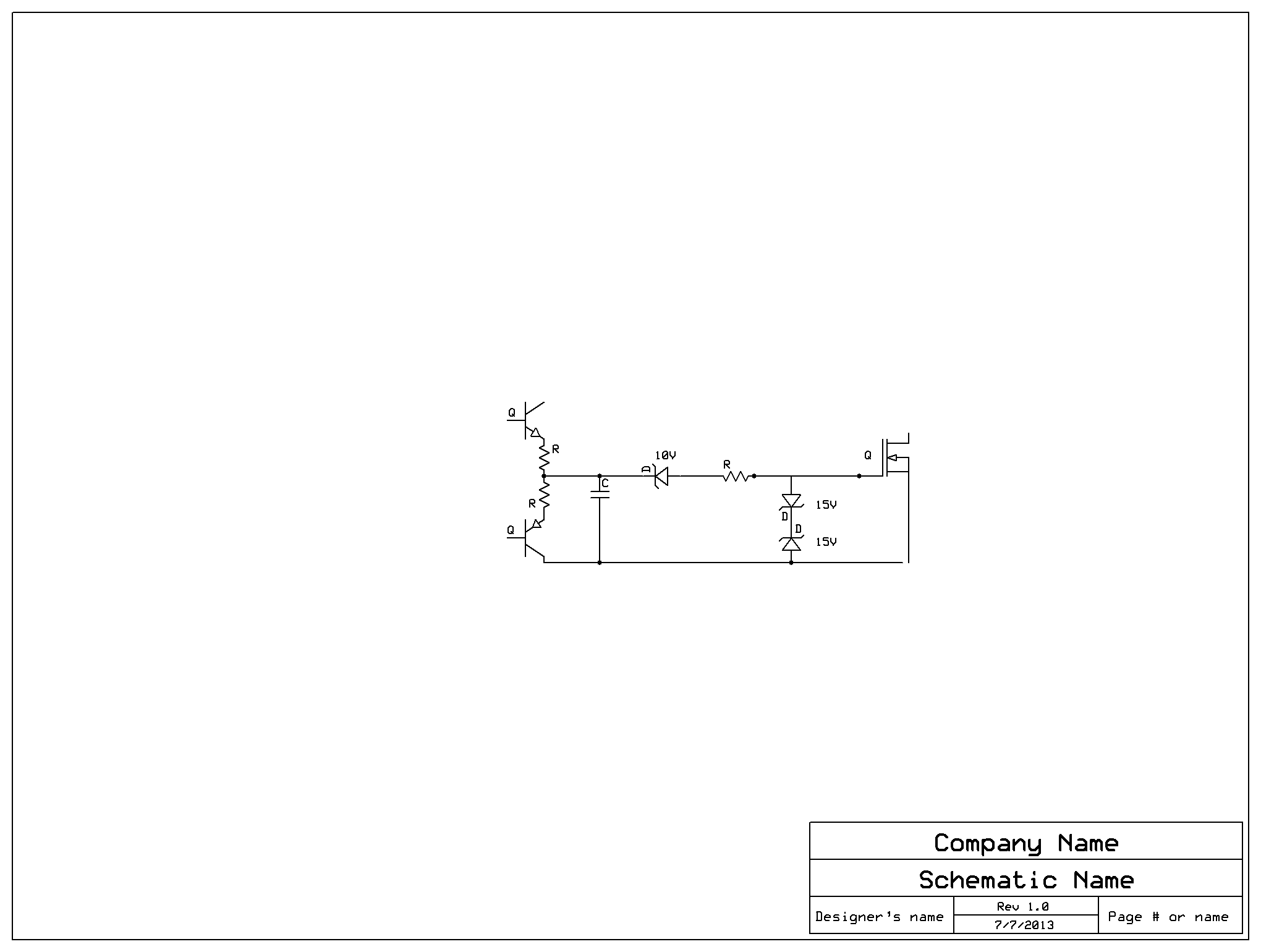

Lets try this. The one you have has trouble turning off the FET.

Ok, thanks ronv. I need to understand it's operation; I see where Q1 turns on M1 and Q2 turns it off, (instead of the resister I am using to drain the capacitive charge off the gate, I suppose that would turn it off quicker) But why put two zeners cathode to cathode instead of one? The purpose of one 15V zener is to insure that no voltage spike ever exceeds 20V on the gate. It seems like two connected like that cancel each other and do nothing. (unless it does something not obvious)
And what is the purpose of M2? It is placed across the full voltage of the charged capacitor with no resistance, which would burn it out if it were on any time except when capacitor was discharged. Since the charged capacitor will be somewhat large, a high grade pulse duty film capacitor, may need some small resistance to limit charge current within transistor capability, or more than 1 transistor in parallel if it ends up being too much for one to handle.
In my application the switch is kept on for maybe 80% of a cycle, turned off momentarily, (a mechanical switch in preliminary experiments, but hall effect switching will be the main method) the charged capacitor discharges catastrophically through a HV diode into an arc fired by a coil, then the switch turns back on to recharge capacitor. The only reason to turn off the charge to the capacitor is to prevent the supply power from shorting out along with the discharging capacitor.

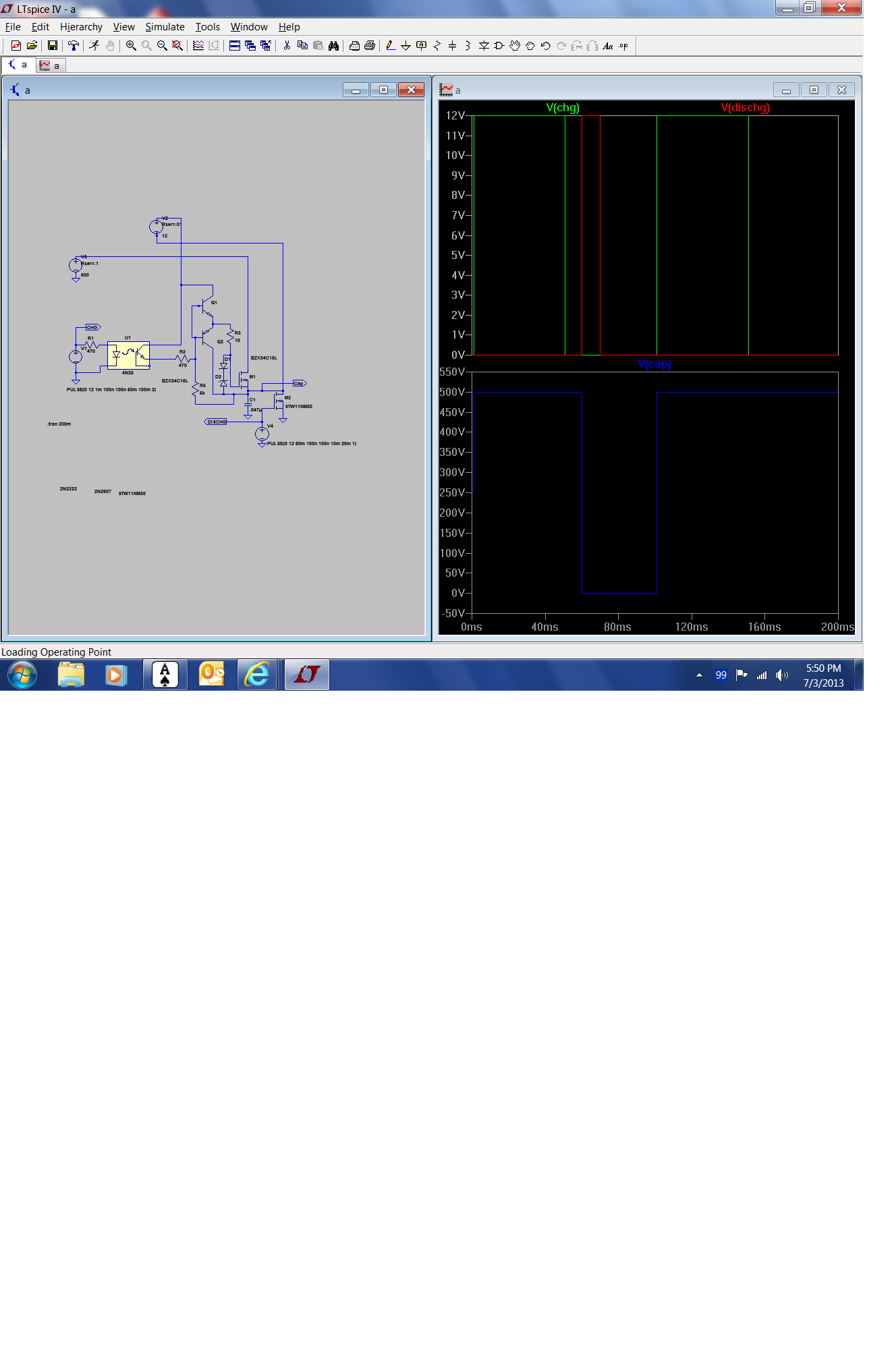

I don't know how fast the discharge takes place but I suspect really fast. I used M2 to simulate your discharge (Just for the simulation). When the cap discharges the source is pulled negative with respect to the gate. Since the is capacitance and some leakage on the gate the FET turns on again. This caused a big current spike thru M1. With the transistor the gate to source are tightly coupled. I'm not sure how your IBGT will act. I'll look around for a model.
The zener looks like a diode in one direction and a zener in the other so this configuration protects the gate to source in both directions but still allows the FET to turn on. I'm not sure they are needed but with 500 volts and a few amps flying around I thought you were wise to put them in.
I ran it with an IGBT to compare. Looks better with the IGBT (lower gate capacitance I suspect). There a quite a few unknowns.
How fast is the discharge.
Limiting resistance etc.
Size of capacitor.
Anyway, you can see the effect.

Ah; thanks; My electronic thinking is a bit slow and/or rusty. After all it's been almost 30 years since I was studying it, and that was entirely radio circuits, haven't done much since, other than put together a few variable pulsewidth motor control circuits.
OK so it really needs an active gate discharge to take the gate down to 0 with the source, (or emitter in the case of the IGBT) and keep it there. I have a bunch of 2N3906 that should work, although a bit lower current capacity than the 2N2907.
