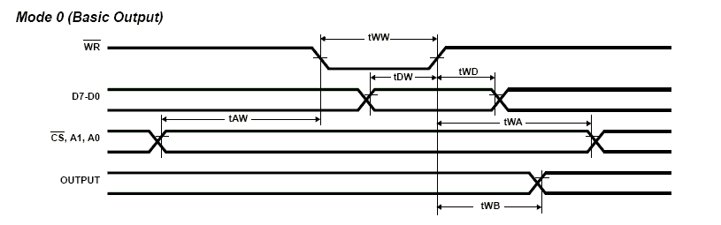

HI,
You have connected /WR to logic 0 permenantely,
So the 8255 is always in write mode
but when you write something to 8255 and to transfer that data to the actual pin, the /WR has to go high and after some delay the data appears on the port pins
https://www.electro-tech-online.com/custompdfs/2005/05/fn2969.pdf
refer to waveforms on page 7 in the above link

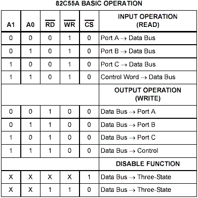

WR to HIGH ?
isnt if i want to send data from D0-D7 paralel port to control word PPI8255 it require LOW for WR ?
and from parelel port to port A PPI8255 also require LOW for WR ?
or i just doin wrong.. :lol:

Have you properly reset the 8255 when it is first powered ON before sending commands to set its operating mode?
Check the below figure
When /WR is low the data is written to port A register
and when /WR becomes high the data in port A regsiter appears at output which is the physical pin
ctrl-alt ,
notice that on the rising edge of your Write signal is when the data is available..
now i am not positive on this , but , you may still have to latch the data ,to be able to see it..
