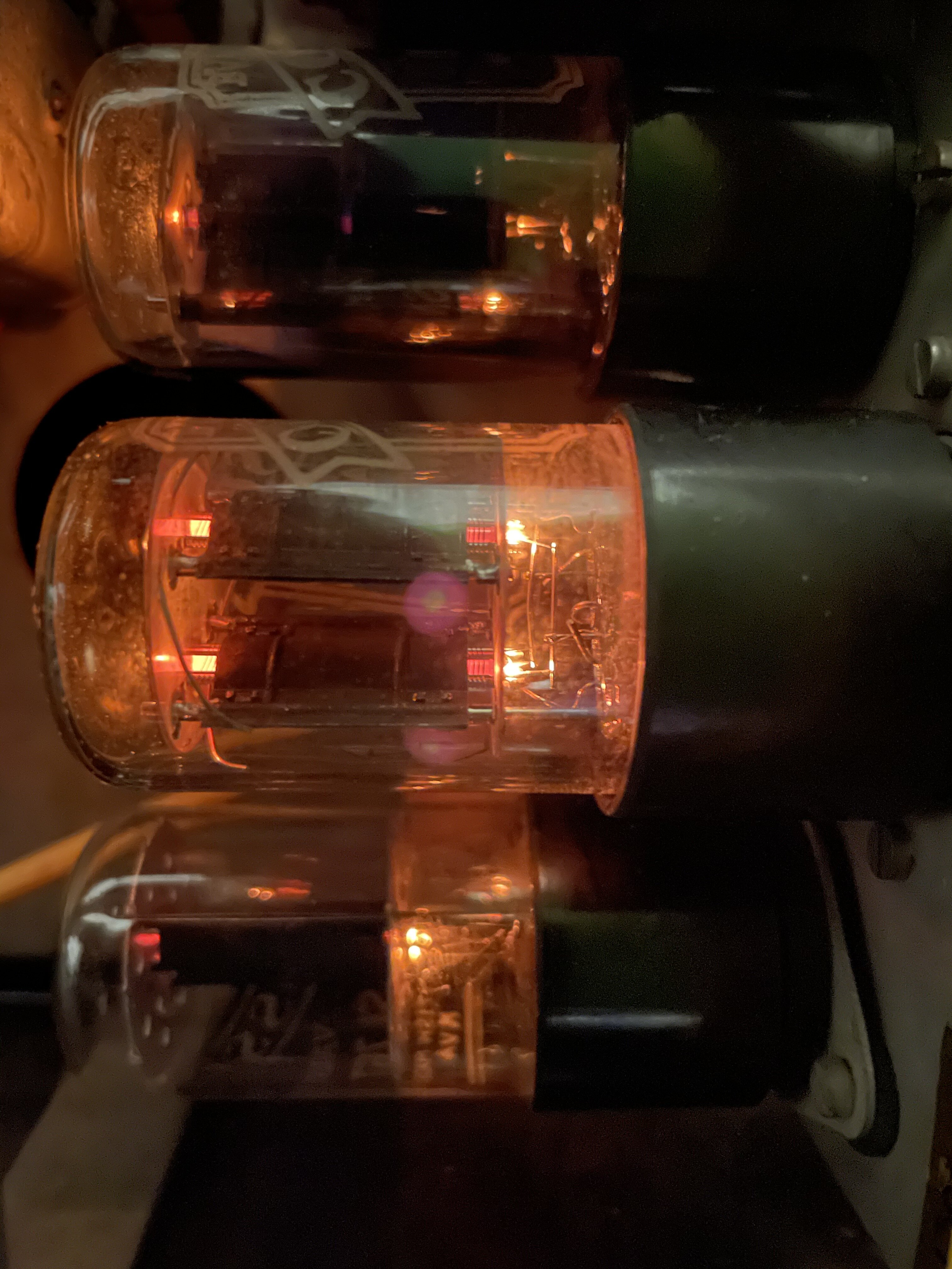

The whole thing screams "gimmick" to me. Having had a look at the full schematic the actual "preamp" in the thing is transistors and IC amps; and the audio outputs are driven by IC amps.
The valves may be in the middle of the circuit but do not appear to do anything essential or even useful.

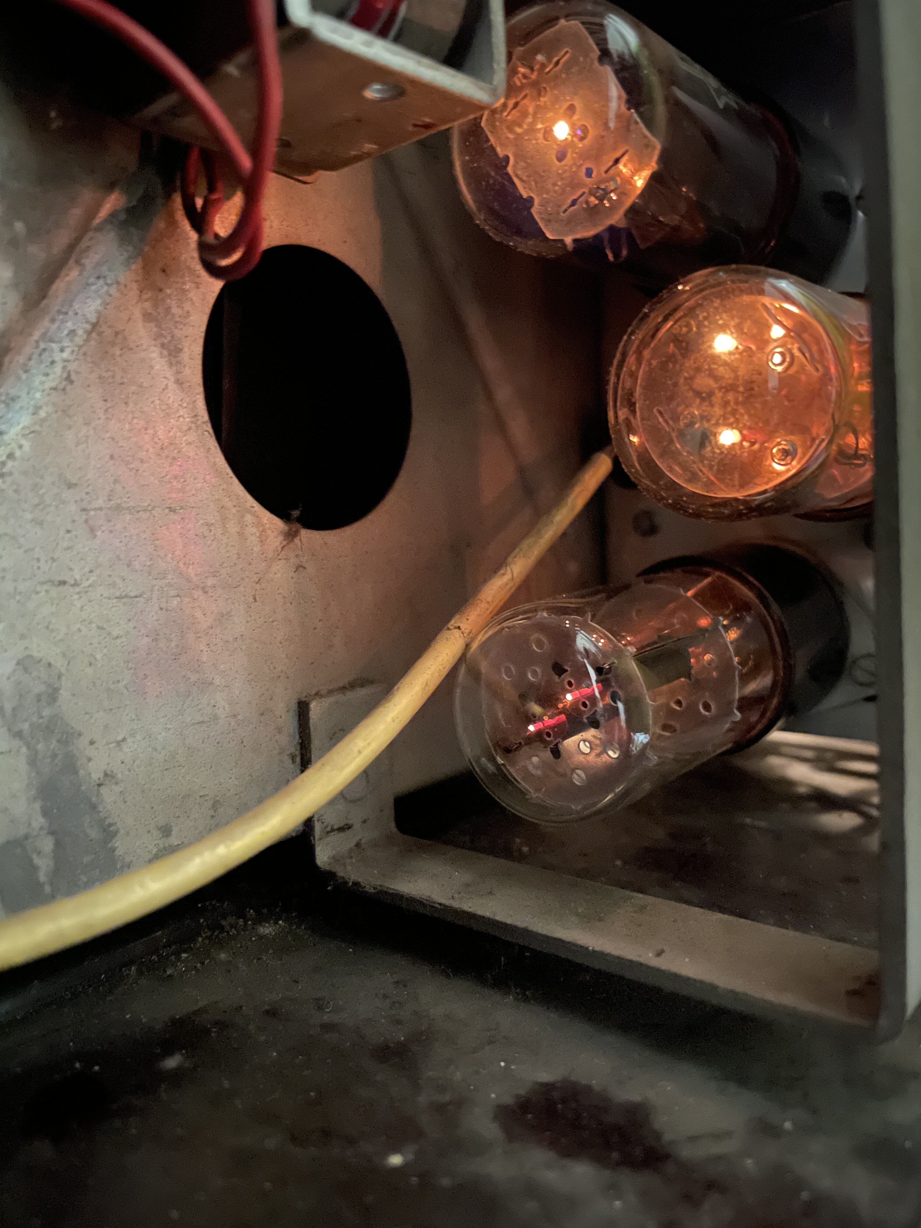

Just for info, these are some rather older and larger valves, the originals in a 1950 recorder I've been working on recently.
The filaments, cathode tubes and general structure are rather more visible in these:

Well I originally thought somewhere along the way power wasn’t reaching the tubes, but I guess it’s something else. Those tubes do look a whole lot brighter.
A friend of mine has two vintage reel to reels. With visible tubes and they get pretty warm!
I shaded the area before taking the photos, so the filament glow was clear. I think your photos were just in brighter ambient light so the filaments did not stand out so much from the background.
Re. voltages, you need to check the anode and cathode voltage of each valve section as well - the filament supply being on is a good thing, but that alone does not mean they are working.
If both channels failed simultaneously I'd look at power supply voltages before getting in to details on the audio path parts.
