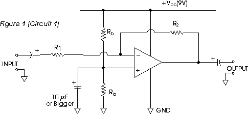

Queation 2:
I hooked up a preamp circuit using a LM741 and send the output to the amp I built with the LM386. Needless to say the output to the speaker is very bad quality.
Is there anything special I need to do with the output of the preamp before it goes to the input of the audio amp?
I have attached the LM741 preamp schematic
Thanks all
-newb

Queation 2:
Thanks all
-newb

Check out the Schematic at the bottom of Page 6 on that PDF file.
Getting too close to the Mic, can cause Feedback. Especially at a gain of 200.
