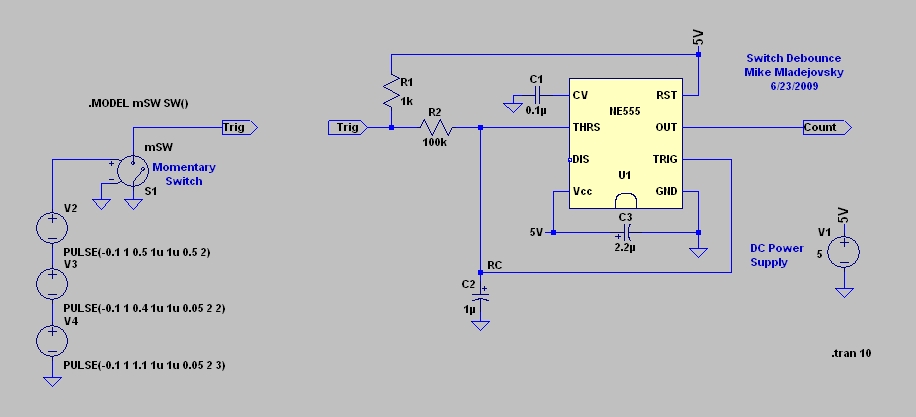

I am trying to add a rep counter using 3 7 segment displays to my home gym. I want to be able to preset the number of reps and have it count down with a bell/buzzer at the end. I am putting detect switches on my equipment to detect the rep. All of the circuits I can find with presets count down seconds not button pushes. Does anyone have a circuit to do that?
What kind of switch?
Two connections (normally open or normally closed) or Three (normally open/normally closed/common)?
Regular N/O push button or magnetic switches.
Ok, that requires a robust debounce circuit to eliminate multiple down counts.

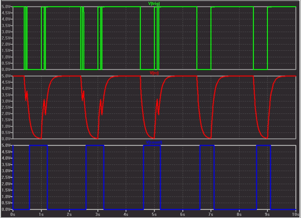

Your counter circuit probably uses a 555 as a clock source. You can substitute this circuit for whatever your counter uses as a clock. I simulated extra pulses which may or may not come from your switch to make sure that this circuit eliminates the multiple edges...

I'm confused. Do you have a presettable counter circuit which counts down by seconds? If so, disconnect the clock source (1Hz pulse) and replace it with the "Count" pulse in the circuit I posted above.
