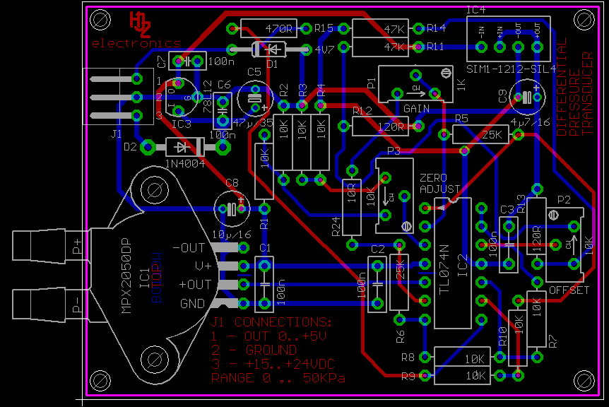

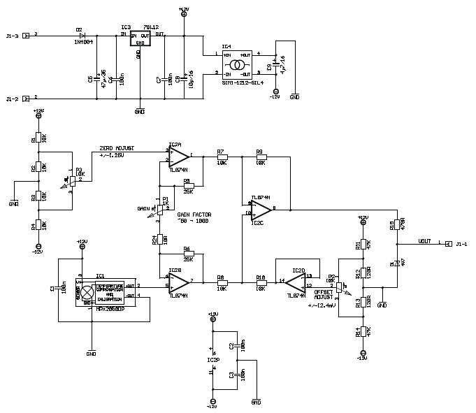

Hi vne147,
why don't you use a Motorola/Freescale pressure sensor type MPX2010DP?
It's a laser trimmed differential pressure sensor with temperature compensation.
The MPX201DP has a range of 10KPa and should be well within the range you want to measure. 1PSI=6.97475793KPa
Here is a circuit with in- and output offset correction and adjustable gain with factors 50 to 1,000.
The schematic uses the MPX2050DP (range 0 - 50KPa), but works with any of these sensors out of the MPX-series.
Regards
Boncuk

EDIT: Boncuk, can you please repost the schematic at a higher resolution? I'm having trouble seeing the component values and IC names, etc. Thanks!

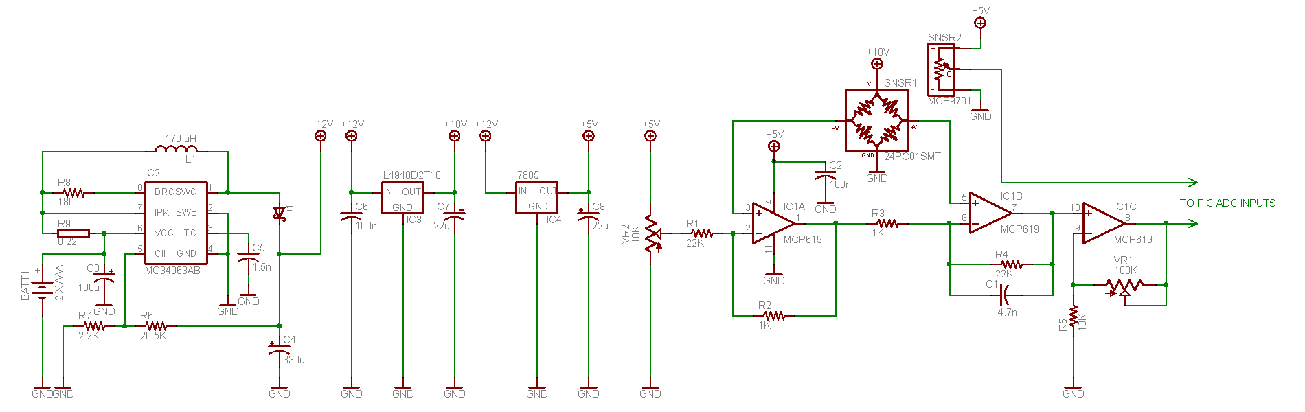

OK, I finished laying out the schematic minus the PIC and display.
Basically what's going on is I have a DC-DC boost converter to make 12V from the 2 AAA batteries. That 12V then becomes the input to a 10V LDO voltage regulator (the L4940D2T10-TR) and an ordinary 7805. The 10V output from the first regulator is used to power the pressure sensor only. The 5V output from the 7805 is used to power everything else (op amps, temp sensor, PIC, etc).
The differential output from the pressure sensor is fed into the MCP619 op amp where I'm using 3 of the 4 available op amps. The pot VR2 is for offset adjustment and the pot VR1 is for gain adjustment. The output from the op amp IC1C will connect to an ADC input pin on the PIC.
Last but not least, there is a temp sensor (the **broken link removed**) that I will mount to the body of the pressure sensor. The output of the temp sensor will connect to a second ADC input pin on the PIC. I plan to use the temperature reading to apply a temperature correction factor that I'll have to determine at a later time after some testing.
Anyway, there's my first go at this. Please don't be shy and tell me what I did wrong and how I can improve the design.
Thanks!
