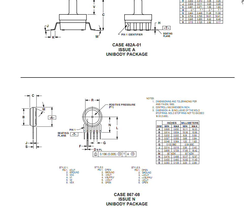

D deal2die New Member Feb 23, 2011 #1 i need the pin details about the pressure sensor MPXV 5050 GP i got the data sheet but cannot find which pin is +Vcc and Vout..
ericgibbs Well-Known Member Most Helpful Member Feb 23, 2011 #2 deal2die said: i need the pin details about the pressure sensor MPXV 5050 GP i got the data sheet but cannot find which pin is +Vcc and Vout.. Click to expand... hi, This should help, if not post your datasheet. Attachments AAesp01.gif 49.7 KB · Views: 380

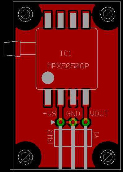

Boncuk New Member Feb 24, 2011 #4 Hi deal2die, in case you still have problems with the pinout here is a PCB design. Boncuk Attachments MPX5050GP.gif 11.2 KB · Views: 304
D deal2die New Member Feb 24, 2011 #5 Boncuk said: Hi deal2die, in case you still have problems with the pinout here is a PCB design. Boncuk Click to expand... thnx buddy...
