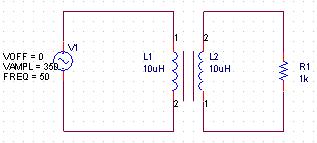

It is said in wiki that the primary current equals Is*Ns/Np.
If there's no load connected to the secondary winding, then there's still current flowing in the primary winding.
But according to the formula from Wiki (that is derived from Pin=Pout),
if Is=0 then Ip=0.
What is right then?
Some current is always going to flow in the primary. It's connected to an AC source after all, the impedance of the primary is usually designed to be as high as possible so this current is as low as possible. Another example of where theory doesn't match the real world.
Thanks.
I drew the next circuit:
transformer-jpg.29940
By ohm's law, Ip = (V_amplitude/√2) / (ωL1).
On the other hand, by conservation law (Pin=Pout), Ip = (Ns/Np)*Vs/R1.
As you can see, the results are different, so what is Ip equal to?

Look at he schematic, the primary is nothing but an inductor dead shorting an AC source to ground. Calculate the inductive reactance add the DC resistance of the coil and that's how much current is going through it.
I popped the inductance of your coil at 50hz into the calculator bellow and got an impedance of 3.14159k there's no resistance listed in your circuit so the current should be around 110ma. I'm not sure if I'm missing anything.
Pin=Pout ONLY in theoretically ideal situations, which never occur in the real world.
Pin and Pout (real power) are equal. The input current due to the transformer inductance is reactive power. It does not contribute to real power (power that generates heat or energy).
The resistance of the coil will cause real power to be lost. EVERY single transformer based wallwart I have ever used always stays warm even if there's no load.

I wonder, what real power is consumed by and transferred by the primary winding to the secondary winding?
Maybe you could please explain the equation Pin=Pout?
What is exactly Pin and what is Pout?

Could you explain please what Pin relates to, and what Pout relates too?
To my knowledge, the primary coil transfers magnetic energy to the secondary coil through the magnetic flux lines.
This magnetic energy is reactive energy, right? since the magnetizing current is the one who creates it.
So how do the primary coil transfers real power to the secondary coil?

According to whats written there:
Its Sin=Sout, and nout Pin=Pout, where Sin is the apparent power dissipated in the primary coil, and Sout is the apparent power dissipated in the secondary coil.
So the question still remains:
- Does Ip equal (V_amplitude/√2) / (ωL1) (by ohm's law) or (Ns/Np)*Vs/R1 (by Sin=Sout)?

The primary current will be (V_amplitude/√2) / (ωL1) when the secondary is unloaded. This is called the magnetizing current, and lags the primary voltage by 90 degrees.
When loaded, the primary current is approximately (Ns/Np)*Vs/R1when the secondary is loaded. This is an approximation for a real transformer, but is generally adequate for most applications. See the Wikipedia entry for Transformer. Pay special attention the the Equivalent circuit section.
Some transformers have a high loss because they are never used at low power, always at max power like the transformer in a microwave oven. Then the windings do not have enough expensive turns of wire to make the transformer low loss.
that's because the laminations are still energized and approx half the Watts loss comes from the laminations and half from the copper;)
