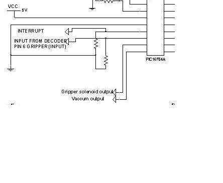

thanks for ur correction.............. other than my program....... do u think that the interrupt can work perfectly???? wat i want to do is when the system is interrupted, all the port will set to zero to turn off all the motor it will turn on the motor at portb,5 for awhile (delay) then turn off the motor at potrb,5 ... after that.... i will standby to wait my signal send~~~
I tried this ... but after interrupted.. the motor at portb,5 just turn on.. forever..... at least i reset the supply...... WHY YA?????? wat i sure is the inteuuprt probelm~` but i dunno where~~~~ pls pls pls...... (@_@)

Gundam82, how did you connect the RB0/INT pin?
If it is left floating it might spontaniously trigger the interrupt over and over again, wich will result in the led staying on...
You should also add context saving to your isr, but in this case i don't think that's the problem.
Thanks everyone.............. EXO.... i connect my interrupt pin series with resistor to ground.... to pull UP..... here i attach my connection...... erm.. hope someone can help me...... about the interrupt?? is that possiblre i need to clear the interrupt flag o waT?? aii~~~~ headahce~~ just a small problemm... make me like this~~~~~ HELP :(
