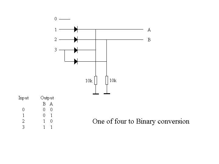

Hello to every1 well i m facing a problem in circuits ..question is
*) Draw a Circuit diagram of a diode matrix to encode 4 input lines of BCD information into a binary count of a 4 stage register ?
well send me the ckt plz at faisal_rjazz@hotmail.com
n plz a bit of description if u can
I don't understand the question.
Do you mean you want to encode 4 input lines into binary, ie. a "one of 4" to binary conversion?
Len
well i want a diode constricted diagram tht convert 4 lines of input of BCD code in to binary counter .....ur first option
Your description
"convert 4 lines of input of BCD code in to binary counter"
still does not make sense.
BCD means "binary coded decimal", but you appear to be wanting to convert "one of 4" to BCD.
The attachment is what I assume you want. If not, please explain in more detail. A diagram would help.
Len
