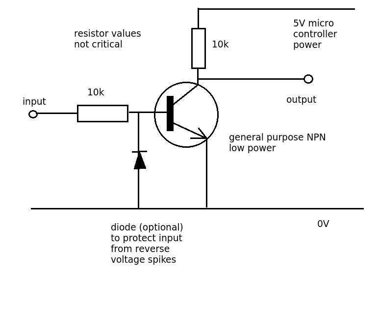

yes i want only one led to glow when metal detects(wireless)
i have both RF modules and HT12e,d encoder decoder...
MY friend told me about BC547 register and told to connect like this...
Take pin 3 from
metal detector, give to base of transistor with 10k resistor. emitter
is grounded. connect RF trasmitter pin to collector. then collector
is connected to 5v with a 10k resistor.
circuit image is down..
will this work????

Yes, that will work.When the base is low the out collector) is high. That is what you want to enable the encoder. You may need to reduce the base resistor but that is what you want.
Ron
I would start with 10K as shown and work down. Actually around 2.2 K or 3.3 K should work fine.
Ron
Ron
both resister shud be 2.3 or 3.3k...?????
can u do me a favor plss..can explain in simple word what will happen when i will connect that circuit...how it works???? my metal detector works with 9v battery and encoder is working with 5v micocontroller power....

Just a moment here. I just saw AG's post which I missed earlier. Bad Ron, Bad, Bad Ron!
The 555 uses a HUGE 100uF timing capacitor so it turns on and off at a few Hz.
AG in his typical format is on target. Wish I had looked as close as AG did at the schematic. The schematic, as drawn, shows a 100 uF cap as mentioned and on the 555 pin 3 a Buzzer and not a Speaker. I need to give this much more thought.
You say the circuit works. What exactly does the circuit do when metal is present verse no metal. I am sorry I let myself get lost in this seeing what wasn't there.
Ron
No details are given about the circuit.
I betcha the coil only has only a few turns so its inductance is extremely low. It begins to have some inductance when some metal nearby becomes its core. Then the oscillator oscillates.
when metal present than it start beeping and when not then beeping sound goes offf....
OK and while that happens what happens at the 555 RST pin? Measure the voltage at the 555 RST pin with and without metal being present.
