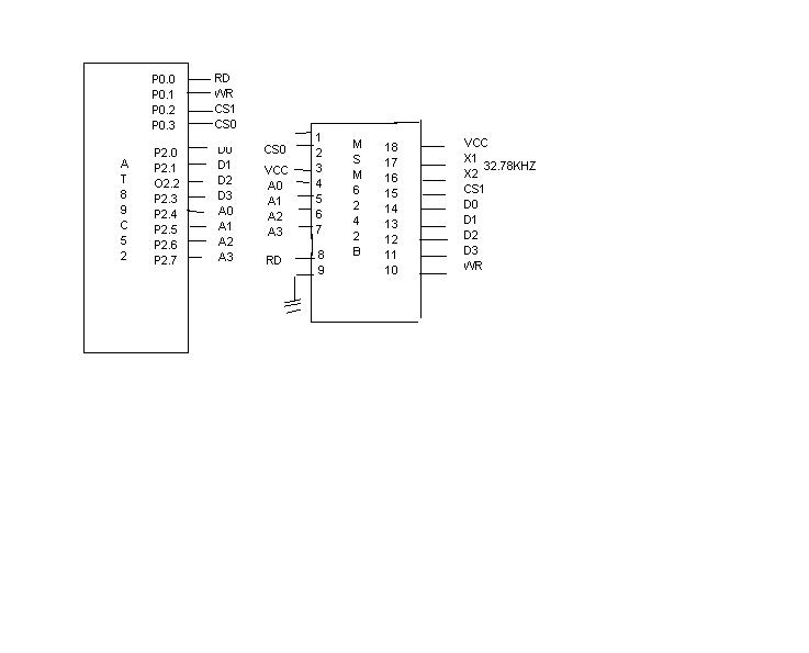

interfacing msm 6242b problem
sir,
herewith i've attached ckt diagram for msm6242 and 89c52 with the same ckt one of my frend wrote a program and getting time and date but i'm not getting where i'm wrong i'm going in the same way as frend only the differenc in ckt is i'm using 32.78khz crystal for rtc and 12Mhz for 89c52 whereas frend used 4Mhz for rtc and 12 Mhz for 89c52 should i increase the crystal value but recomended value is 32.78khz and is it necessory to give high to low pulse on cs0 and cs1 pins for reading and writing pls suggest me the solution
thank you.
Do you know how to read the timing diagram in Figure 4 of the MSM6242B datasheet? Have you complied with the setup and hold times required of CS1 and CS0, and can you confirm this with an oscilliscope?
To make a valid transaction you need to study the timing diagrams in the datasheet. As I see it you need to take CS1 high for the whole transaction. You need 1 usec = 1000 nsec before the address bits and CS0 change. How do you ensure that? After the transaction is complete there is a address hold time before CS1 goes low. How do you ensure that?
I seriously doubt that your friend used 4 MHz as the crystal for the RTC.
You realize that this part is obsolete and not recommended for new designs, right?

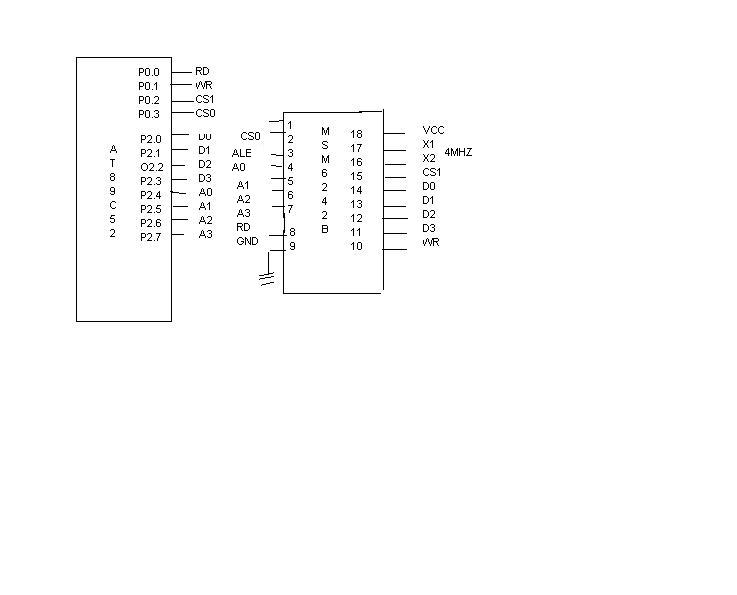

msm6242b interfacing problem
sir,
in the following code its giving the data which i've writen in the respective
registers but there is no increment in the values its always showing the same data what are the steps to read rtc pls suggest me.THE OUTPUT IS LIKE TIME: 12:51 , DATE:12:05:06
thank you

If you had an oscilliscope you could see if the oscillator was running.
I see that you are writing a 5 then a 4 to register F which should reset the fractional seconds counter.
I see that you have written a 0 to register E. Is there any kind of waveform at the STD.P pin, pin 1?
I see that you are writing a 4 to register D which should clear the hold bit.
I can't see anything that would prevent the clock from running.
Sorry.
Edit: Why do you think this poor CMOS part will work at 4MHz. Where did this quaint notion come from?

esconele said:
sir,
i've worked a lot on this but still i'm not getting the results where i'm wrong ?
data is there on chip data pins i checked with oscilloscope but when i read it its not giving why pls help me here is the code pls suggest me the solution

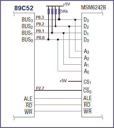

Of course your code would not work. The MOVX command requires ALE, WR and RD signals for it to work. In order to use the MOVX command, you have to connect your RTC as shown.
The ALE, WR and RD signals already existed as standard signals in the 89C52, so why would you want to generate it yourself. You just made your life so much difficult.
With the connections shown, you can use the same method in my code to access the registers on the RTC. Good luck to you.
msm probnlem
sir,
thank you for helping me.
but in your code you are not doing anything with RD WR AND ALE pins but in datasheet it is ghiven that there should be high to low high transaction on WR AND RD pins while writing and reading and CS0 should be low can i use the ffunctions i've written for reading and writing purpose or your code will give the results.thanks a lot sir
