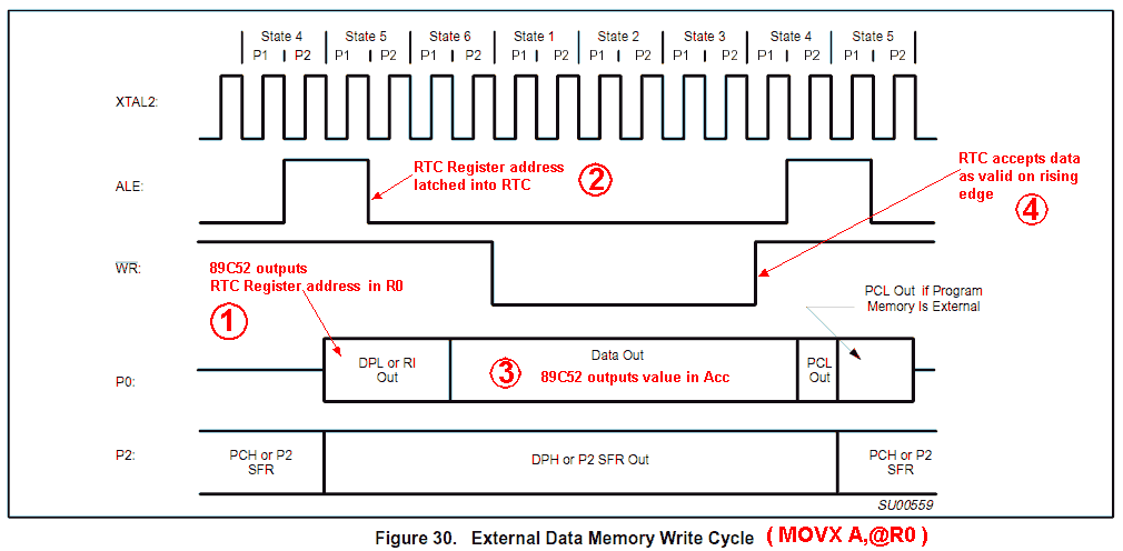

problem in interfacing msm6242b with at89c52
Connect the WR' pin to the WR' pin of the 8051, the RD' pin to the RD' pin of the 8051, and enable the RTC. On memory, there is a CE' pin which must be grounded in order for the chip to be enabled.
esconele said:
sir,
thank you for helping me.
but in your code you are not doing anything with RD WR AND ALE pins...
I don't need to do anything because "the MCU is doing all that for me" when I use the MOVX A,@R0 instruction.
You have to study the 8051 datasheet and familiar yourself with how the MOVX instruction works.
The attached image would help you along.
