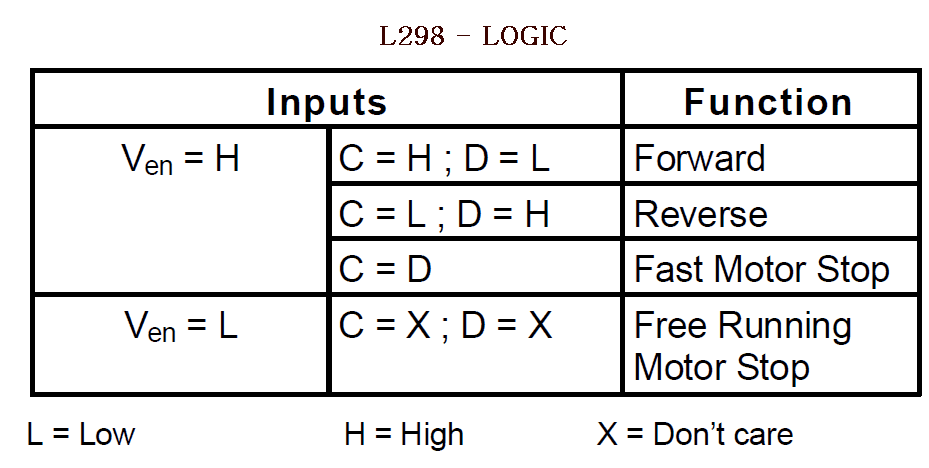

Enable pins should be either high or low to activate the outputs.
The PWM-signals should go to the input pins (IN1 through IN4).
See the function table below.

@ Boncuck:
I red somewhere that PWM signals can be applied also to Enable pins, but i am not sure yet. For now i just test with 1 logic or 0 logic.
