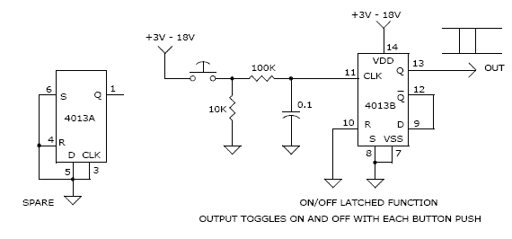

Well, i built this circuit(see attachment) to be used in a switching application. I used the same values of components as given in the schematic except the Electrolytic cap--i used 1uF instead of 0.1uF coz i had that by me then. Vcc in my case is about 8.4V. The problem is that the output pin is always at a Pd of 0V across Ground 8.5V across Vcc--even after pressing the switch. Please help

Well i eventually made it work, somewhat. But once it gets latched it doesn't get unlatched. Any way 2 make this circuit act as atoggle switch?

The RC network on the clock input is necessary to debounce the switch. Otherwise, the flip-flop will toggle several times each time you depress the switch.
Here's the rub - some mfrs (Philips, maybe others) have a Schmitt trigger on the clock input, so the clock is insensitive to transition times. Unfortunately, others (ON Semi, National, Fairchild, ...?) do not use Schmitt trigger clock inputs, and the specified maximum risetimes are around 5 - 10 microseconds. With the posted schematic, the risetime will be around 20 milliseconds. If you used 1uF, it will be 200 milliseconds!
As I said, you have to have some sort of clock debouncing. You can do this separately with an additional circuit, get an HEF4013 from Philips, try to find a Schmitt CD4013 from another mfr, or use another scheme which is insensitive to switch bounce.

The risetime is approximately 2.2 times the RC time constant, which on your schematic is (100k*0.1uF) 10 milliseconds. Switches typically bounce for a few milliseconds, so a short time constant will not debounce the switch.

Ron H explained the reason in his first post. I quote "Here's the rub - some mfrs (Philips, maybe others) have a Schmitt trigger on the clock input, so the clock is insensitive to transition times. Unfortunately, others (ON Semi, National, Fairchild, ...?) do not use Schmitt trigger clock inputs ....."
As he said later, you need to either buy a Flip Flop that has a Schmitt trigger in the Clk input circuitry, or use the one you have but insert an external Schmitt Trigger package such as the 40106, 74C14, etc.
Also, I notice that there is no bypass capacitor shown on your circuit. You should use a 100 nF ceramic across the Vss to Vdd. Otherwise you could see strange behaviour.

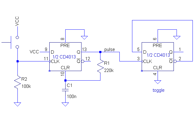

You can use the other half of the 4013 to produce a clean pulse each time you close the switch. You can use this as the clock to your toggle flip-flop.
Here's how it works:
The switch still bounces, but the first closure clocks a "1" (VCC on pin 9) into the first FF.
This "1" starts charging the capacitor on the reset pin. When the voltage reaches the logic threshold, it resets the FF. The RC time constant is set so that the reset happens after the switch has stopped bouncing. The reset pin is not sensitive to rise time.
See below.

apakhira, If you want pure simplicity for input, take Ron's last schematic up to pin 11. All he does is create a default logic level of "0". The button when pressed will override the level and make it "1". Once the button islet go, the level returns to "0".

For the two FF circuit shown, bounce is immaterial. The whole point of that first FF is to reject bounce. If you applied that scheme directly to the clock input of the toggle FF, it would seem like a good idea. However, I just don't know what the FF would do when the clock slowly returns to "0". The clock gating is done with analog transmission gates, pretty much identical to those in a 4016 or 4066. With the slow edge, I think the internal logic states may become unpredictable during the logic threshold transition.

I didn't understand why a slow rise time would not work for toggling to`0' state (i wanted u 2 explain the internal cause of it). Now, about the first part of the FF circuit since i didn't have the 100n cap(C1) and a 220k(R1) resistor i did the following:
  • 1. I put a 510k resistor and 1uF cap, thinking that though the pulse time would be around 510milliseconds, the risetime would be low. But that didn't work
  • 2. Then i put a 100k resistor in parallel, making resulting resistance of R1 aroung 85k. Now, the thing acts like a mommentary on/off switch--the 2nd FF is in "1" state as long as the switch is pressed, then resets to 0. In rare cases it works. Sometimes it is even reversed and i get 0 when switch is pressed. Why?
No what do i do? btw, i presume, the simple circuit which mstechca proposes, is in the original circuit, except the pulldown resistor?[/list]
What kind of switch are you using? I was going on the assumption that switches only bounce on closure, but I'm finding out that some bounce on opening also. This could explain the problem you are having.
