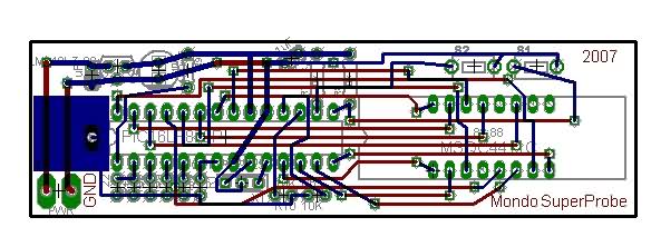

3v0 said:
If you do not have a scope a logic probe with a high enough input impediance might show pules if the crystal is working. IIRC the Mondo superProbe will check the frequency. But I like the scope better because you can see the waveform.
Did you actually build the Mondo superProbe?
PS hope the crystal works out to be the problem. The loopback test should have worked though regardless of the crystal.
He has the loopback working all the way to the processor TX RX pins. I was thinking he just needed to download the OS but that did not fix it.
I have built two version of the Mondo SuperProbe. The first has the processor and display stacked one board on the other. The second and more useable one is a single board. I have Eagle files for both and could post them.
I used a resonator instead of a crystal. According to the author of the circuit the resonator is not stable enough for the video signal generator but all else works. It should not be too hard to add the caps so a crystal can be used. Added a bypass cap for the PIC.
