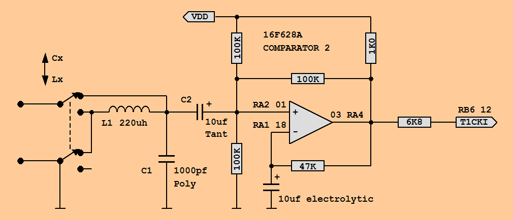

I was thinking on doing a PCB for the might be popular LC meter. There is a better 16F628A version. I'd like a frequency & duty counter too if I did it. Might base it on a 16F88 instead. Would also like to see if it's possible to get the internal comparator working in the design.

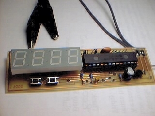

I think this would be a good kit. I like the idea of a probe but finding a ready made case has proved to be difficult.
The EA is a lot more complicated then theSuperProbe which has more functions. Maybe the EA is more accurate. The LED display on the SuperProbe is obsolete and it should be replaced by a LCD if anyone updates it.
I am not crazy about having 4 AAA cells. Given that it uses an LCD display maybe one could use a charge pump. The SuperProbe is powered from the circuit under test which takes another lead.
The SuperProbe has a voltmeter function that I use. I saves having to pull out the volt meter when the probe is already in use. I have also used the RS232 signal generation/injection.
For me a good probe of this sort would be coded in C and have an ICSP connector. That would allow me to customize it to do things like send and receive packets.

Much of the complexity of the Engineers Assistant is the automatic power switching. You could power it off the target and skip the batteries.
I like the LCD too, 2x16 LCD displays are common now. Maybe combine the superprobe and EA... (add a rs232 port too?)
The new 16F886 might be a handy choice.
Ultraprobe?
PS it's a cool case, made of PCB with most of the copper etched out.
wow neat. I like that one as well. But I think I'll start with the superprobe first. While were on the subject of probes, a bit off topic, but does anyone else have a list of cool tools to build like the SP and EA
I got the internal comparator working as an oscillator on a '628A Bill. It ties up the TMR0 T0CKI pin (RA4) though so I had to setup TMR1 as the frequency counter and I fed the comparator output to the T1CKI pin (RB6). Here's how I setup the comparator;
MAIN    movlw   b'00000110'     ;                                 |B0
                                ; b7 = C2OUT                      |B0
                                ; b5 = C2INV                      |B0
        movwf   CMCON           ; turn comparator on              |B0
        bsf     STATUS,RP0      ; bank 1                          |B1
        movlw   b'00001111'     ; RA4=output, RA0-RA3=inputs      |B1
        movwf   TRISA           ;                                 |B1
        movlw   b'01000000'     ; RB6 = input (T1CKI)             |B1
        movwf   TRISB           ;                                 |B1
        bcf     STATUS,RP0      ; bank 0                          |B0
Just need to fabricate a new prototype and finish the software. I was using the serial port and Hyperterminal instead of an LCD.

That's excellent Mike, Creatron is looking for kits as the DIY kits are old news and the Velleman kits are pricy.
I'll try to build a 16F88 version, I'd really like to do something along the Mondo superprobe too.
