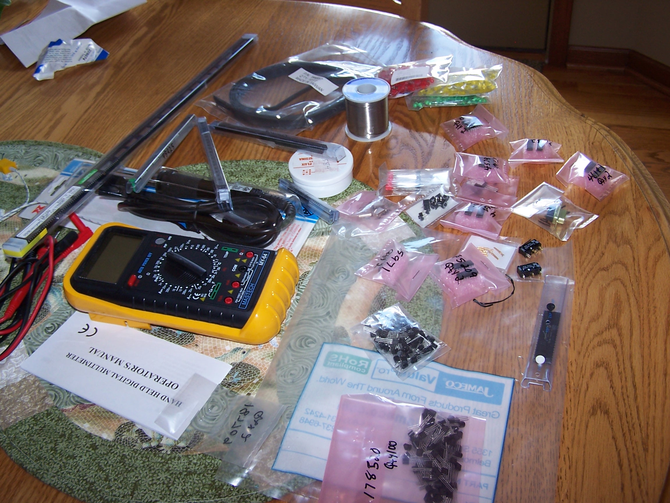

The picture is the box of my microcontroller stuff that I ordered, plus other stuff i needed. the multimeter is a Mytech MY64. Very nice and sturdy design. I love it. It includes a thermocouple for temperature. 42$
(I heart transistors, so I ordered 100 of each: PN2907A and PN2222A)
