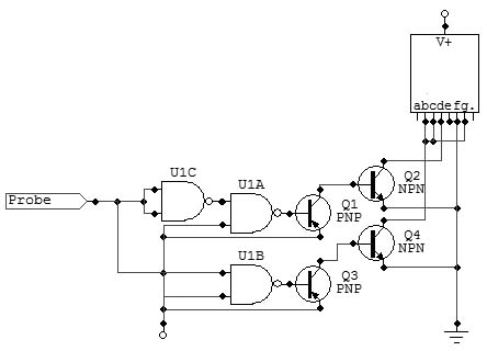

I want this to display low when the probe is floating. I thought it should looking at the design, but it displays high. It functions properly otherwise. Does anyone have any suggestions to fix this?

If it is CMOS inputs leaving it floating can cause it to go high. You must pull it low with something like a 100k resistor.
