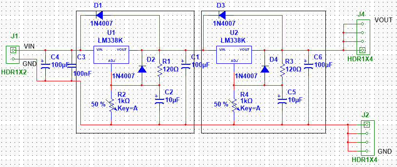

So back to topic, how about this, i would use 2x LM338 in series, the first one will be set with R2 to drop voltage from 15 to 10.5 (that will give 22.5W with 5A (can drop from the 5A requirement) and second will drop voltage by another 4.5V (same power dissipation) resulting with 6V. Note, the current of 5A is absolute maximum but not constant, from my predictions the usual constant current might be in between 2-4A so the power dissipation will be a bit more lower.
Does resistors next to D2 and D4 should have higher power rating or they can be regular 1/4W ?

Can I strongly recommend that you get hold of the data sheet.
From my reading of the data sheet, you cannot dissipate 20 watt of power in this device unless the case temperature is held at 40 degree C maximum. Given 5 amps and a voltage differential of 5 volt there is 25 watt of power to dissipate. Your suggestion to use 2 LM's in series does nothing to solve your problem because each device will have a voltage differential of 5 volt. I dont know if you can operate the LM at a voltage differential of less than 5 volt. To get the device dissipation lower, you will have to either reduce the voltage differential OR reduce the current in the device. To get to 10 Watt dissipation, the differential voltage will have to be reduced to 2 volt and this is the minimum for most series pass regulators.
The maximum current that you can really pass in the LM338 is around 2.5 amp. The data sheet, page 17, shows the arrangement.
Reducing the current to 2.5 amp at 5 volt differential gives 12.5 watt. The temperature rise, (j to ambient at 40 deg C shows a thermal resistance of 6.8 degree C per watt. Given the LM338 has 4.4 deg c /watt allows the heatsink thermal resistance to be 2.4 degree C per watt. This is still a big heatsink but possible.
I checked the RS catalog. They have a stock nr. 507-5021 which has a 2.5 deg C /watt rating. It is described as "TO220 extruded 2.5 C/W". It has a flat section for bolting TO220 devices. It's size is 75 mm L x 70 mm W x 25 mm H. The local price is around 7 AUD.
You will still need the ballast resistor to reduce the input voltage to around 11 volt. It will dissipate 55 watt!!!.

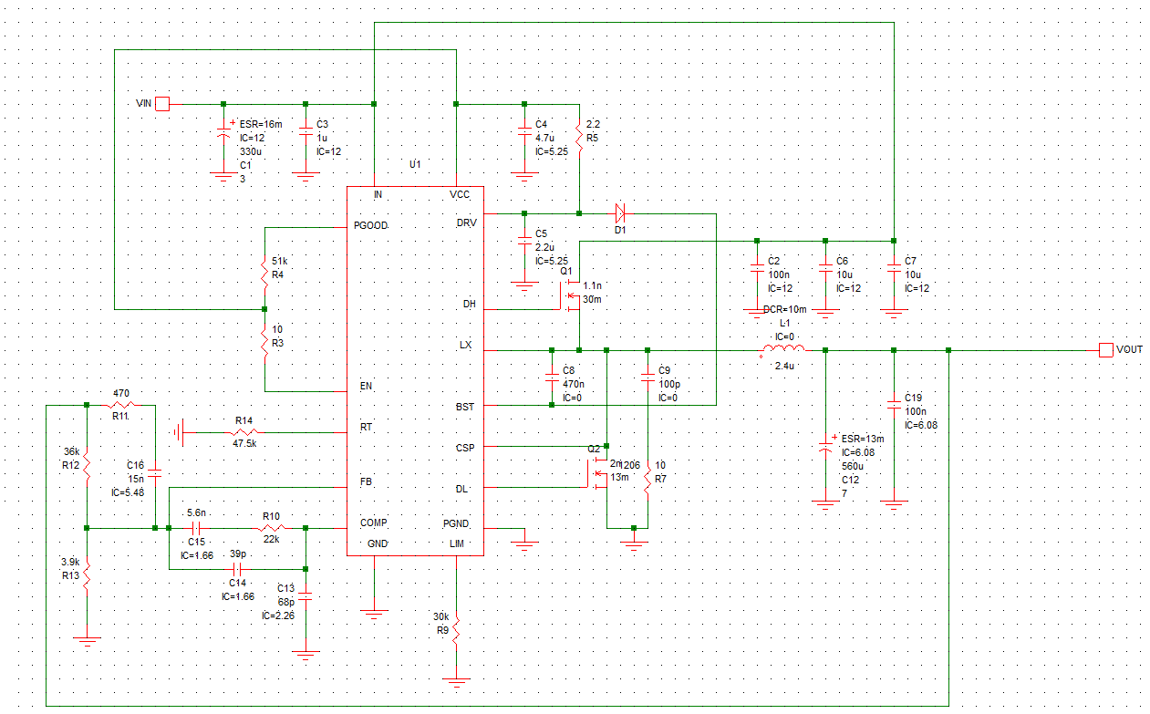

I got a hold of a few MAX15046 ICs and tried to make a DC-DC converter on them from (12V to 6V current from 3 to max10A) but i ended up on trying to select appropriate parts but somehow stopped there, this is what i made so far:
A schematic and i i looked through some parts and figured that:
Q1 - SiS478DN Rds(on) 30mΩm, Qgs 1.1nF, Vgs(th) 1.2v, Id 12A
Q2 - SiS436DN Rds(on) 13mΩ, Qgs 2.0nF, Vgs(th) 1.0v, Id 16A
L1 - DE1207 2.4uH, 10.3A, 10mΩ
I wasnt sure about diode, initially i picked ES2D-E3/52T 200V 2A diode but dont really know why, not sure what kind of diode it should be and what ratings.

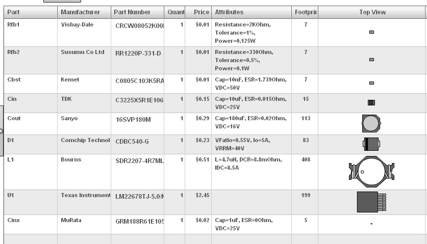

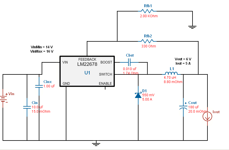

If you are headed to switching......
This being one of your first projects.....
Lets keep the parts count down.....
Hi konrad,
What Ron has put up looks OK. Check the data sheet for your self. Most, (all?) of these stepdown switching convertors are similar. There are 2 problems with ALL of them;
1. you need to get the inductor right; it must not saturate during the ON cycle. If the inductor saturates, the ON time is too long.
2. The diode MUST BE a Shottky diode. This type has a quite low forward voltage drop and this is important when you are looking for a 6 volt output.
