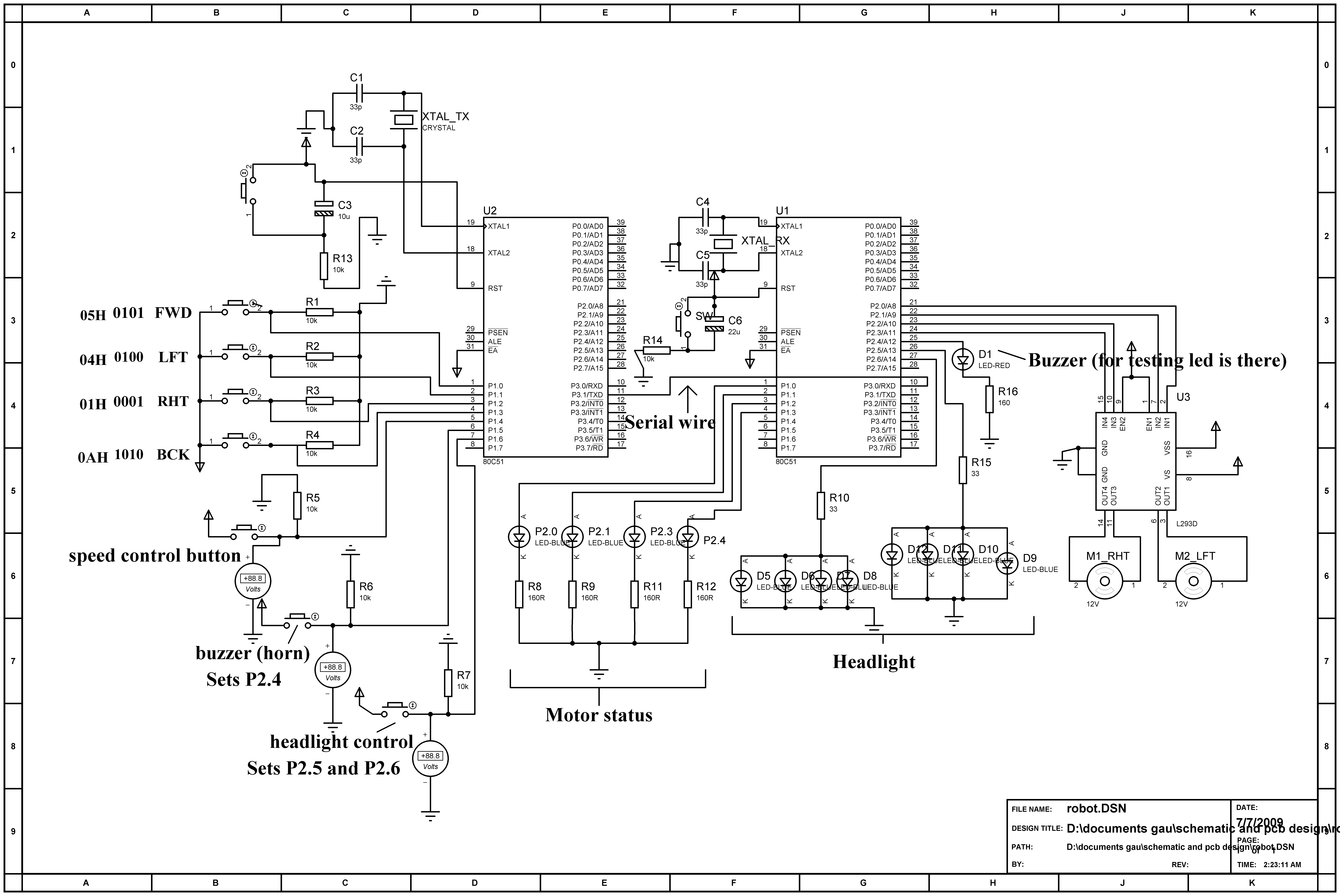

Take a look over my schematic. It is wired not wireless as my simulation software(Proteus) don't support wireless simulation.
And I am also having the encoder/decoder description as follow
So looking over the channels in schematic and that supported by above IC....the problem can be overcome by using this IC's along with 8051 without using Manchester coding ???
Regards
Gaurav Sharma

Hi Nigel
I want to ask that can i send a pulse train mean duty cycle(like in order to vary the speed of dc motor) say of 70% using Manchester coding in the program ?
Waiting for reply...
With Regards
Gaurav Sharma

But in my program me controlled the speed of motor by making a pulse train of 70% duty cycle using timer and then fed it to the L293D driver when appropriate button is pressed at transmitter unit. Let us suppose we have we want forward direction of motor. Then in this case at IN0 of L293D we have that duty cycle(70%) and at IN1 of L293D we have 0 considering only single motor.
So by combination of IN0 and IN1 the motor doesn't get 100 percent power. As in my case there is 70% duty cycle so only 7/10 percent of total power is fed to motor so its speed is slow.
Now tell me how can I send this complete pulse train in 8 bytes:confused:
You don't, you send a single digital number (one byte) for each motor - this allows you one bit for direction, and seven bits for speed. The receiving microcontroller generates the PWM based on those values.
If all you're wanting is simple radio control, why not just use a standard radio control system and ESC?.
Look over the schematic in post #55 this is what I want to control.
oh OK!! I got you...you mean to say I have to make that pulse in receiving microcontroller rather than in transmitting microcontroller. And generate that pulse in receiving microcontroller by single bit from transmitting microcontroller...right ?
