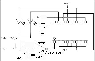

I am making a TOSlink switch to accept 4 incoming audio streams and has one output. to switch between them all, instead of using a 4-way mechanical switch, i wanted to use one button to cycle between the 4 inputs..
I realised early that a 2-bit binary number should do the job nicely, after doing a bit of research and checking the inventory at the local electronics store, i went for a Dual J-K Flip-Flop i got a MC74HC76 Click here for datasheet.
I decided to test the idea on a breadboard, I wired up 2 LED's so i could see the binary cycle (off-off,off-on,on-off,on-on) as i pressed the button. i plugged everything into a breadboard as shown in the image below
now everytime i press the button, i get a random set of leds. sometimes it doesn't change, sometimes it picks a random sequence, and every so often i get the next light in the sequence, i pressed the button 20 times writing down the result and did not see any kind of pattern forming. so i am at a total loss.
I added a resistor and a capacitor between the not gate and clock 1 just in case there was some kind of interference on the push button hoping to maybe smooth out the button press, but there was no difference.
I appreciate any ideas on how to get this to work
Without looking deeply into your circuit I notice you are trying to clock a FF with a switch. You can't do this as a switch is mechanical and it will bounce, ie. make lots of on off connections after first depress. This in turn may toggle your FF and give you random results. You must debounce your switch. Have a look at this article. http://www.ganssle.com/debouncing.pdf

To overcome your problems which are almost certainly due to contact bounce in the switch, I suggest that you modify your circuit as I have shown below.
Also, add a decoupling capacitor between the +5v line and gnd.
A 0.1uf in parallel with a 100uf would be good to have.

Hey Guys,
bouncing does sound like the source of my problem.
i used the caps and resistors you suggested Jimb and removed the not gate. however i am still getting the same problem. is there anything else you guys can suggest or different values for the cap and resistor?

Look at this modified circuit.
If required increase the 100nF upto say, 1uF.

Hi ericgibbs,
I followed your circuit to the letter and it now works perfectly, Thank you so much. Thanks to all for your input
