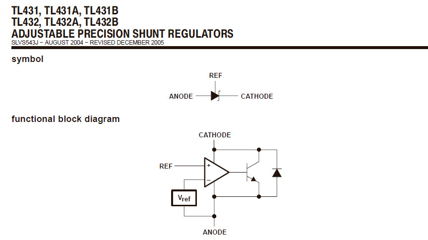

Look at the attached functional block diagram which comes directly from the TL431 data sheet. Note how the device works. It has an opamp with the inverting input tied to the internal voltage reference, which is 2.495V. The non-inverting input is the REF pin. The output of the opamp drives the base of the NPN transistor whose collector is the CATHODE pin, and whose emitter is the ANODE pin.
REF has a very high input impedance. The opamp amplifies the difference between V(REF) and 2.49V. The open loop gain of the opamp and NPN is greater than -1400, so only 1mV of difference causes the CATHODE pin to change by -1.4V.
The TL431 can be used as an audio "amplifier". It can also be used as a comparator, where the voltage at the REF pin is compared to 2.495V, and V(CATHODE) is low if V(REF)>2.495V or is high if V(REF)<2.495V. That is the mode I am using it....
Or it can be connected as a programmable Zener, or used directly as a 2.495V reference.
