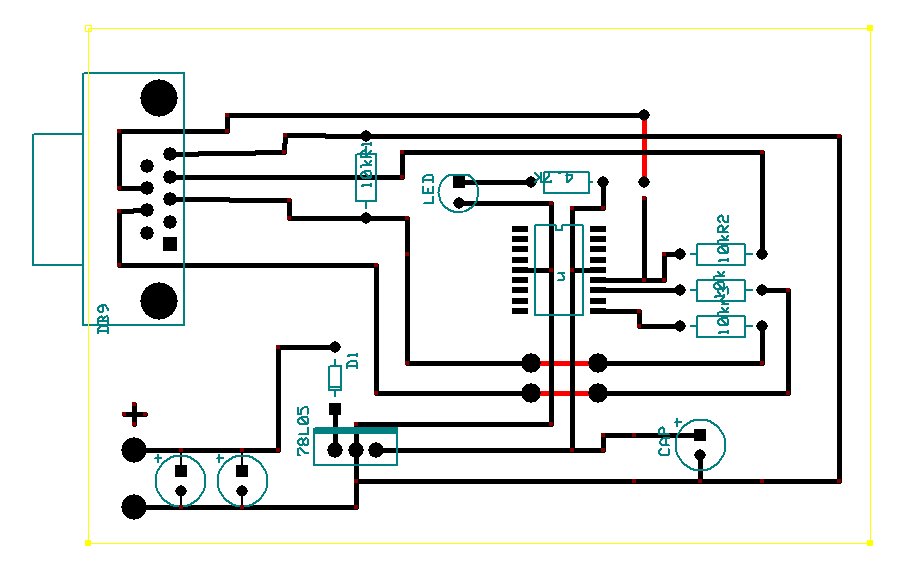

Here is a rough PCB that I made so far. I added the CAPS to the input power and added a few other parts. This is the view looking down at the board if it were clear.
OK, just two notes.
1. is that PCB for SMD PIC?
2. place those ceramic caps, as close to the 7805 as possible, and after the diode...

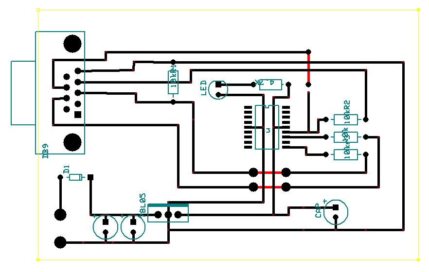

Jay.slovak said:
OK, just two notes.
1. No, it is not for SMD. The first screenshot has all of the layers visible. I added a ss of just the bottom copper layer.
2. Moved the caps.
Thank you Jay!

GatorGuy said:
Jay.slovak said:
OK, just two notes.

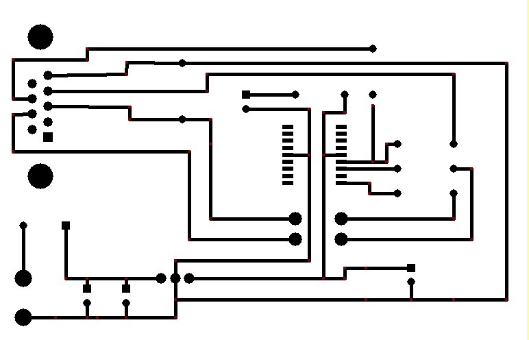

2. Moved the caps.
Thank you Jay!
Well, it looks pretty good, the board is kinda big, but that should be ok.
Jay.slovak said:
GatorGuy said:
Jay.slovak said:
OK, just two notes.
2. Moved the caps.
Thank you Jay!
Yeah that ss's are a little large. I had to leave them that way to show some detail. The actual size is 3.8" X 2.5". This SS is about the right size. Of course I haven’t taken the time to edit it. I like to clean up the lines and square all of the pins. Also the PIC will be replaced by an 18-pin socket. So I will have to move the soldering points.

Would it be possible to put a 78L05 in line with the input pins to regulate the voltage? Or would that affect the data being programmed?
Oh absolutelly NOT!
1. Data are bi-directional
2. that IC would corrupt data...
But using Zener diodes would be Ideal!
Jay.slovak said:
Oh absolutelly NOT!
:idea:
Gotch Ya! I will work on that.
