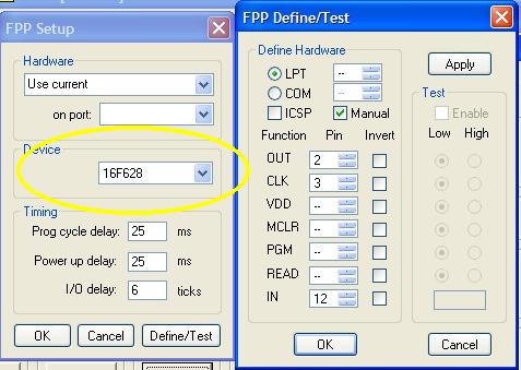

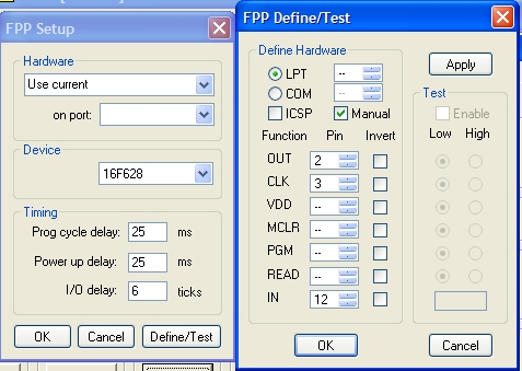

I used to use this circuitry
to program the 16F628 PIC using FPP. It doesn't work with the 16F628A.
What to change (hw and sw) to program this kind of device

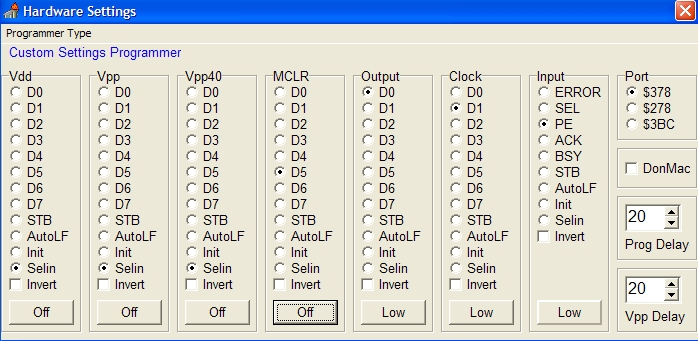

Thank you for your suggestion. I do not need to design and build a new circuitry but I need to adjust the values for the program to work with my device.
Currently WPP treats the device as it wasn't there. Do you see the problem's cause on the attached screenshots ?

The 16F628A and 16F628 use totally different programming algorithms....
Your problem is that you need to select 16F628A instead of 16F628:

If only he had to select 16F628A then I don't think he had asked. The following is the device list included in FPP.
DEVICE device[] = {             /* list of known devices and sizes */
    {"16F83", 83, 512, 64}, {"16F84", 84, 1024, 64},
    {"16F85", 85, 1024, 64}, {"16F86", 86, 2048, 64},
    {"16F627", 627, 1024, 128}, {"16F628", 628, 2048, 128},
    {"16F870", 870, 2048, 64}, {"16F871", 871, 2048, 64},
    {"16F872", 872, 2048, 64}, {"16F873", 873, 4096, 128},
    {"16F874", 874, 4096, 128}, {"16F876", 876,  8192, 256},
    {"16F877", 877, 8192, 256}, {NULL, 0, MAXPM, MAXDM}
The FPP programming software was created in 2001 and does not in its device list has the newer "A" types of PIC which require a different algorithm to program them. I have the feeling that Nigel's WinPicPro is a more updated or expanded version based on FPP judging by the hardware menu.

The 16F628A and 16F628 use totally different programming algorithms....Your problem is that you need to select 16F628A instead of 16F628
Good idea, I also came to this conclusion before.
Since you have tried using WinPicPro but it does not work, you have no choice but to upgrade your hardware.
This programmer is to be used with another program than FPP; I used it with FPP and it worked. It is similar to DT's "Quick and Dirty". Additionally I don't know if it doesn't work at all. This is why I uploaded these two screenshots for you to understand what was entered/adjusted wrong.
No, I've never heard of FPP - I suspect he showed screen shots from both programs - and WinPicProg far predates FPP, WinPicProg was the worlds first Windows based PIC programmer (long before MicroChip moved to Windows).
Have a look at **broken link removed**. The screenshot I uploaded not being titled FPP is showing WPP's properties.
